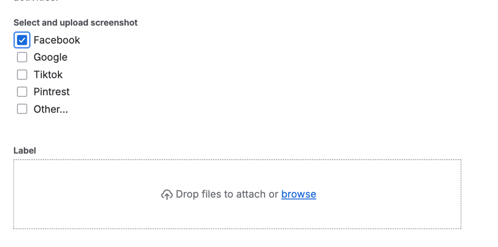

how to right logic in JSM form if we select the option then side by should get the attachment
Abilash
July 22, 2026
how to right logic for each option in JSM form if we select the option then side by should get the attachment not downside,it is possible.image (50).png

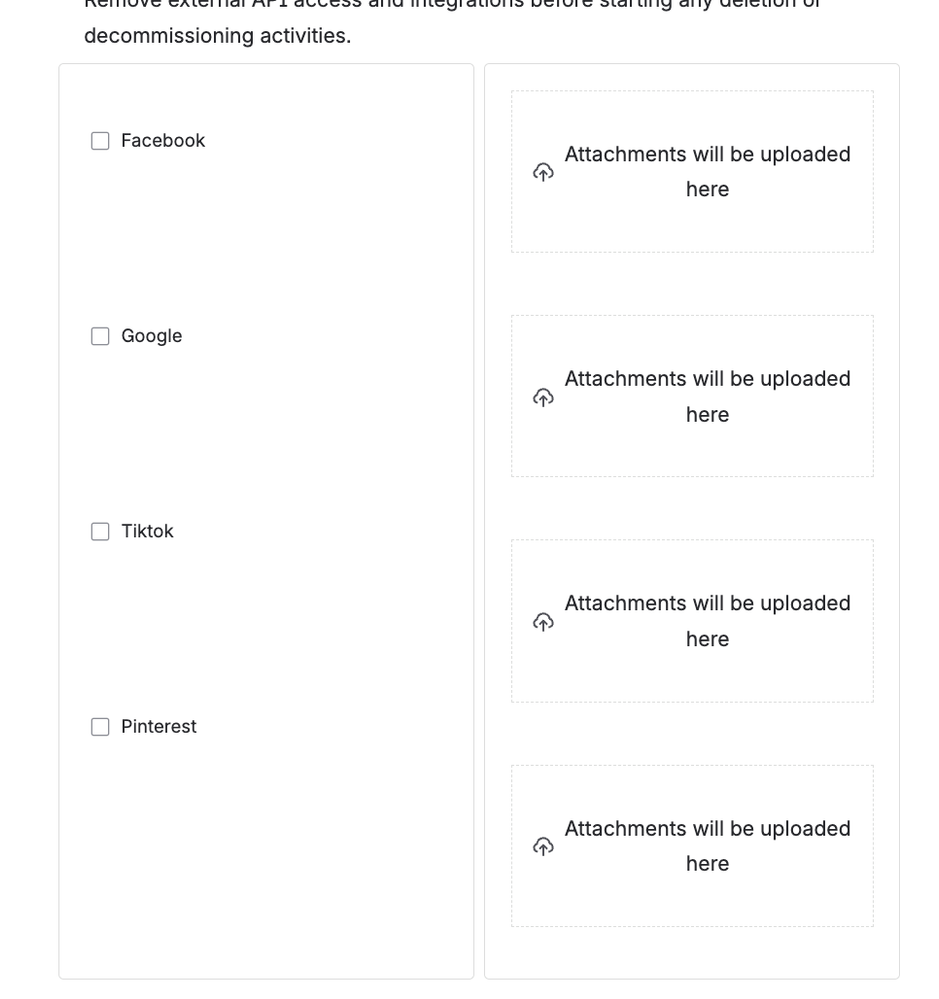

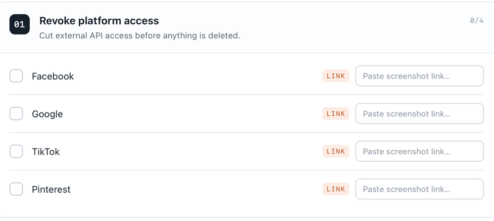

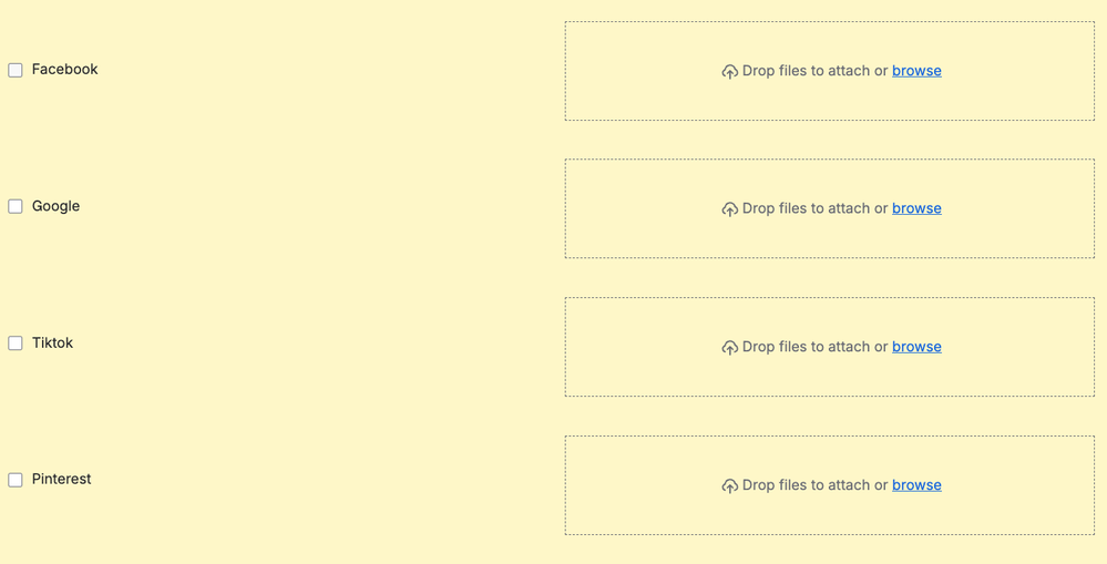

Abilash
July 22, 2026
@Arkadiusz Wroblewski ,Thanks for reply,
created layout and showing like this attachment side by option.

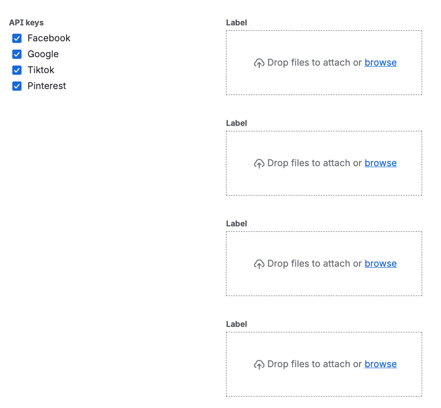

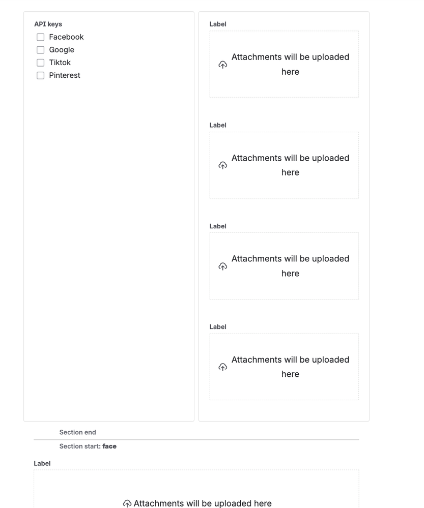

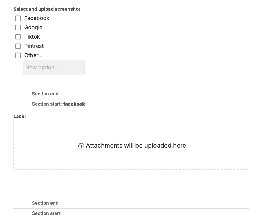

Abilash
July 22, 2026
Hi  ,Thanks for response.Already created the JSM form,but my manager asking to get the attachment at side by not downside when select spefic option in checkbox,when i  written logic for layout and checkbox,the attchment showing downside,it is possible to get side by of that option.image (51).pngimage (52).pngimage (53).pngimage (54).png

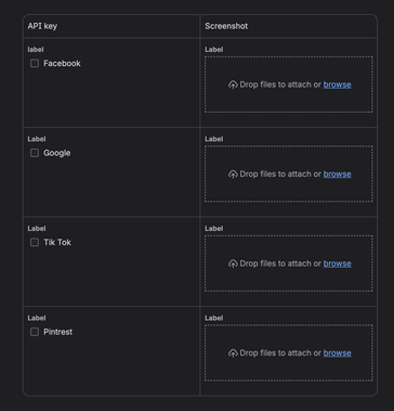

Marc -Devoteam-
July 23, 2026
Hi @Abilash
As I mentioned.
Side by side is an option using a table or layout option.
Don't create custom fields in your space or Jira.
Just use fields in a form.
What you need:
  • For each API key a check box field with a single option.
  • Set the fields below each other when using the layout option on the left side or add each option in to a table row, based on a 2-column table
  • For each Attachment a attachment form field option
  • Set the fields below each other when using the layout option on the right side or add each option in to a table row column besides the related checkbox. option, based on a 2-column table
Best option is to use a table.
