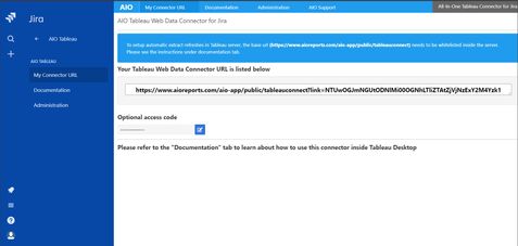

Nihar Das
August 27, 2019
Dear AIO Team,
Could you please help me to get the AIO Connector? We have JIRA in the Cloud. Could you please help to connect with Tableau Desktop?
I have tried with the above link. I am not able to get this page.
It will be really helpful if you explain the steps with some Screenshots.
Thanks in advance.
Navarambh Software - Gmail
August 27, 2019
Thank you for contacting us. Please email us at support@aioreports.com and we will be happy to work with you get the . connector setup.
