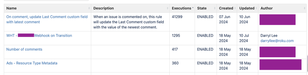

These CSVs can then be attached to a Confluence Page where I used Stiltsoft's excellent Table Filter, Charts & Spreadsheets for Confluence to Transform that data into a table that you can sort/filter for # of executions, state (disabled or not), author, etc.
Oh and the links do take you directly to the rules.
I used the Table to CSV to convert each of the attached CSVs into tables, and those are nested inside of a Table Transformer using the following SQL query:
SELECT FORMATWIKI("[" + CONCAT(T1.'name', "|", "https://SITENAME.atlassian.net/jira/settings/automation#/rule/", T1.'id'),"", "]") as 'Name',
T1.'description' as 'Description',T3.'executionCount' as 'Executions', T1.'state' as 'State',
FORMATDATE(T1.'created') as 'Created', FORMATDATE(T1.'updated') as 'Updated',
FORMATWIKI("" + CONCAT(T2.'name', " <", T2.'email', ">"), "") as 'Author'
FROM T1
LEFT JOIN T2 ON T1.'authorAccountId' = T2.'id'
LEFT OUTER JOIN T3 on T1.'id' = T3.'id'
It's a little... complicated. But yeah, in theory you could plop the shell script on a Mac or Linux host somewhere and have it run every day or week or so, and you'd have a nice sortable/filterable catalog of your rules.

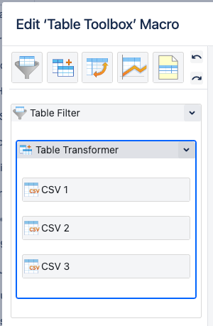

Oh, one last caveat: Cloud Confluence doesn't allow for nesting of macros, so I had to use "Table Toolbox" to put the Table Transformer "inside" of a Table Filter. That looks like this:

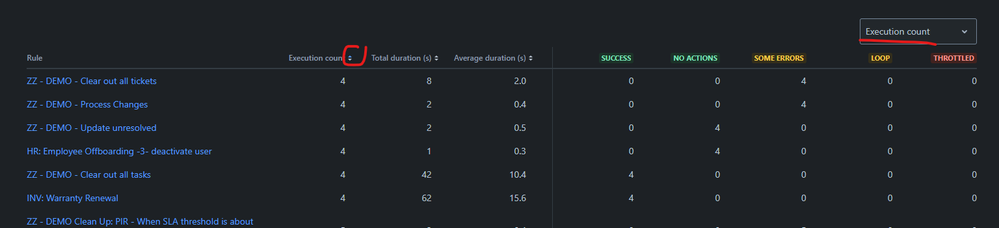

What you could do, is go to: https://<YOUR ENVIRONMENT>.atlassian.net/jira/settings/automation#/performance-insights.
You can also access this through the regular System Administration section > Global Automation > the three dots on the top right > Performance Insights.
On this page, you can play around with the toggles to see the data for i.e. the last month. If you sort by execution count, you could identify rules that don't run that often (or maybe too often).
It only shows the top 20 rules though, so you might not get what you want here.

Hi Hans, no unfortunately this isn't viable for 400+ automations to manually go through each (well i mean sure i could, but heck no i dont want to). The sorting column only seems to bring back results for a small number of automations, so thats not helpful.
The platform falls short of auditing consumption. Surely I'm not the only Atlassian consumer in the world asking this question? Someone has been bound to figure this out already, given how trivial it seems?
