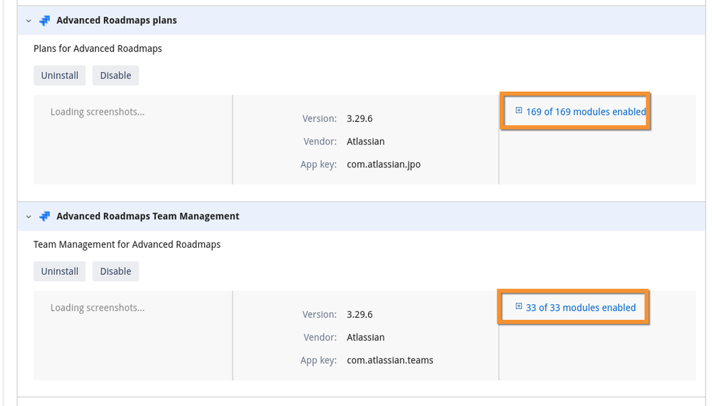

hi @sai chinamuthevi Please confirm if you have installed the plugin and it has all the modules enabled. advanced roadmap is free plugin for Jira data center so not require any license for it to use

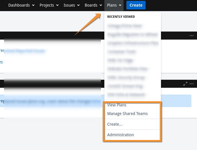

If it is installed and enabled you will see the Plan option in the Jira top bar like below

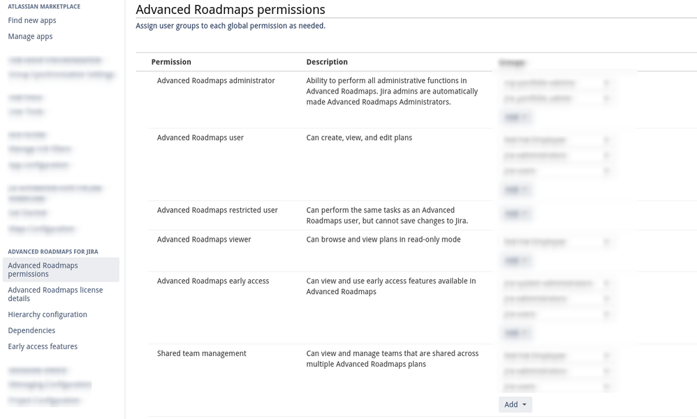

You can configure the further configuration settings by going to the below URL:
https://<jira-base-url>/secure/PortfolioPermissions.jspa

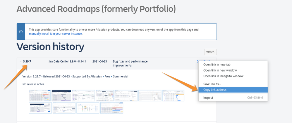

looks like i installed another plugin can you please mention the plugin name and how to activate the modules ?
Sagar Mahajan
May 10, 2021
The plugin name is same - Advanced Roadmaps
https://marketplace.atlassian.com/apps/1212136/advanced-roadmaps-formerly-portfolio/version-history
You can simply installed using the plugin using the URL from the version history

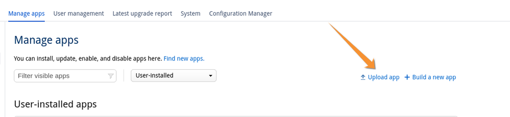

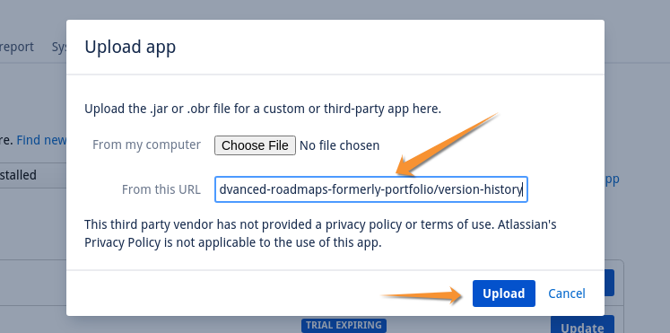

Sometimes you will not able to find the addons from the find new apps options, so above mention way will help to installed the plugins using the installer link.

It does not show on the board. Check the menu bar - you will see a new option called Plan . That is where you create Program and Plans using roadmap plugin.
