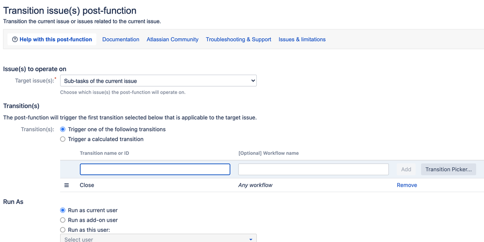

All you have to do is add a "Transition Issue(s) (JMWE app)" post-function to the transition (of the Story workflow or the shared workflow), with this configuration:
- Issue(s) to operate on: Sub-tasks of the current issue
- Transition(s): add the same transition name or ID as the current transition

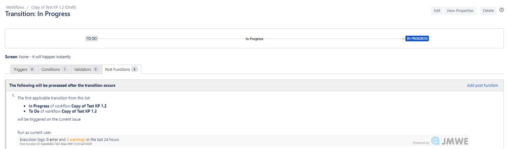

i already try it before. But, it doesn't work.

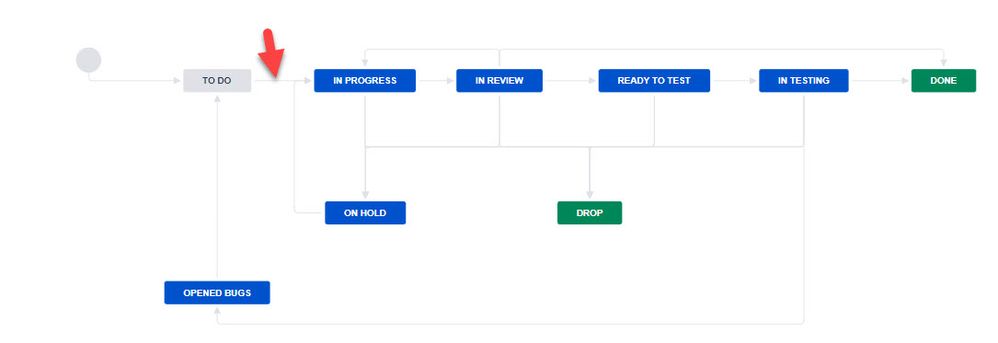

i add the post function on  transition To Do -> In Progress.
 when i try to Move the story (which have 1 subtask) From To DO to In Progress.

Hi @adithya
you didn't select the correct "Target issue(s)", see my screenshot.
