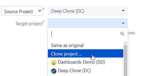

It might be interesting that we released an update for Deep Clone for Jira that enables you to clone entire Jira classic projects (plus components, versions, settings, issues, ...).
