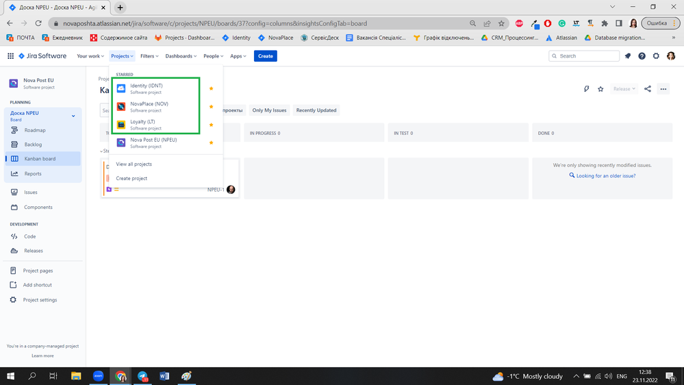

Can you provide a screen image of the screen you are viewing so we can verify what you are trying to do?
All three projects that I highlighted at the top need to bring their user stories to the fourth project "Nova Post EU".
The purpose of this is to track the progress of each project

Projects are containers for issues (user stories). Issues can be in only one project.
An agile board, like the Kanban board displayed in the background of your screen image, is a method to display and manage issues contained in projects.
If you want to combine issues from multiple projects to display in one agile board, you must first create a Filter to retrieve the issues in those projects. This is done through the Advanced Issue Search screen, which is an option under the Filter menu.
To get issues from multiple projects you would use a filter like this:
project in (<project1>, <project2>, <project3>) order by Rank desc
For more information on searching for issues refer to
https://support.atlassian.com/jira-software-cloud/docs/search-for-issues-in-jira/
After creating your filter you then save your filter for later use. For information on saving your filter refer to
https://support.atlassian.com/jira-software-cloud/docs/save-your-search-as-a-filter/
If you want other users to be able to use the filter and see the results of that filter displayed in an agile board, you need to share the filter with those users. Refer to
https://support.atlassian.com/jira-software-cloud/docs/save-your-search-as-a-filter/#Savingyoursearchasafilter-sharing
After saving and sharing your filter, you then can create an agile board that uses that filter. Refer to
https://support.atlassian.com/jira-software-cloud/docs/create-a-board-based-on-filters/
Thanks for your help. I found out I've made mistake all time.
About filters, it's needed setting in board settings-in General-in Edit query filter
And then use
