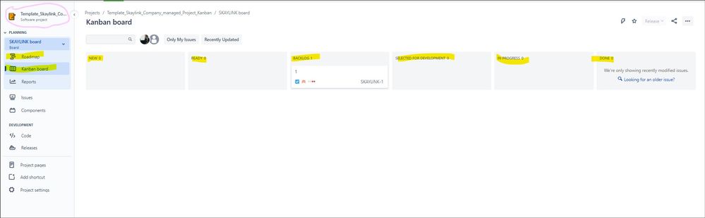

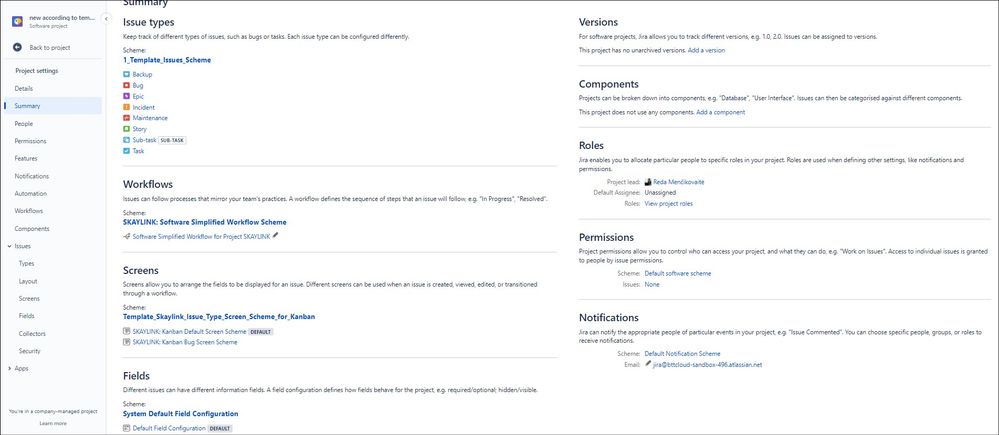

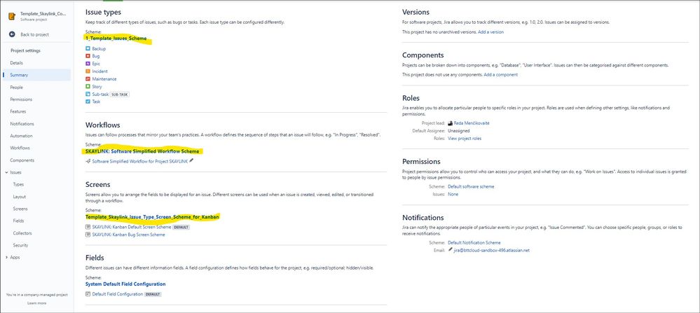

Hi @Ste Wright , it should be working but something goes wrong.
If I compare both project settings>project summary they are identical.

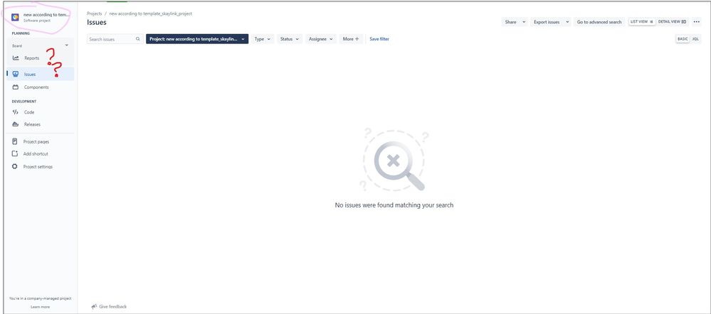

But looking from user interface I cant see board module, roadmap. I'd like to share two prints screens for more details, maybe you would know there is the problem.
Maybe you know what setting I might missed?

Hi @Reda Menčikovaitė Project manager
Even though you receive a Board (which includes a Roadmap) when you create a Project from a default template - they're not actually a part of the Project.
A Board is the visualisation of a search filter - and it can contain one Project, or multiple, depending on the search parameters.
If using Share settings with an existing project, you will need to create a Board for the new Project manually.
To do this...
  1. On the left-hand side, select the Board drop-down menu
  2. At the bottom of the list, select + Create Board
  3. Choose a board type
  4. On the next screen, select Board from an existing project
  5. Give the Board a name, and choose your newly created Project. The location should be the same Project
  6. Select to Create board
Let us know if you have any further questions :)
