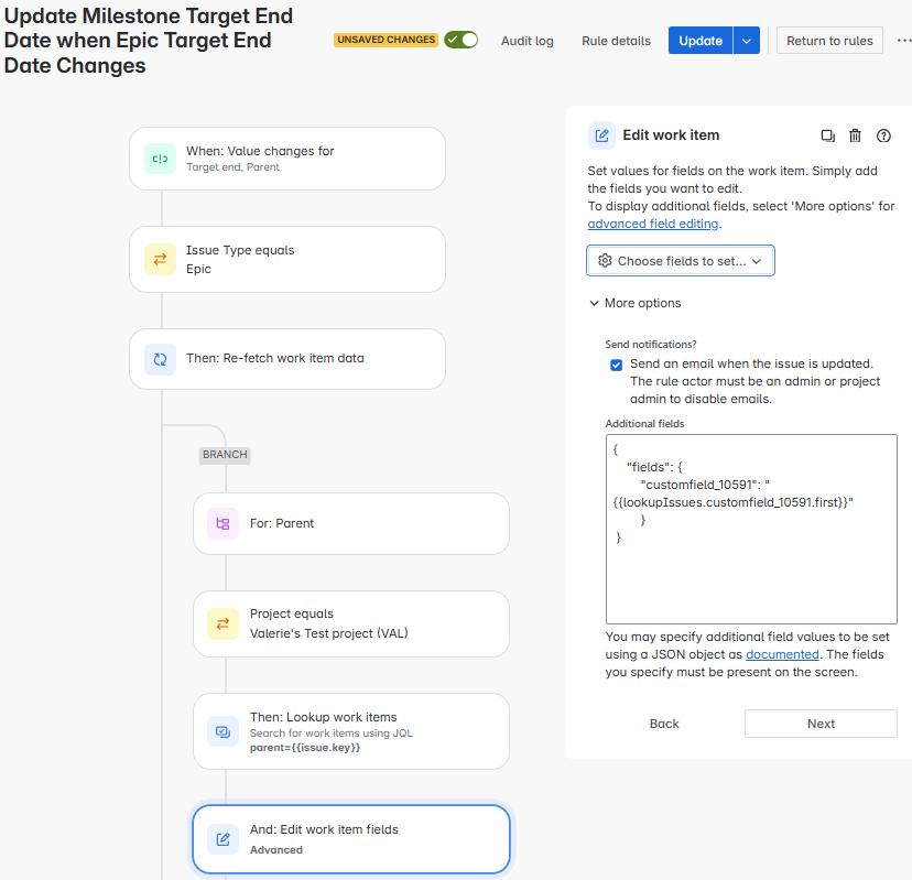

Here is a screenshot of the rule as it was working with the first selection.  I was hoping to be able to set it with max, as I mentioned.
Valerie
July 16, 2025
And I just used your suggestion to sort using JQL and it worked like a charm,  Thank you so much for your help!

Bill Sheboy
July 15, 2025
Hi @Valerie -- Welcome to the Atlassian Community!
Is that the built-in Target End field?
If so, I believe that is provided to rules as a text representation of the date, and so the list max function cannot operate on it until the text is converted to a date.  For example, please try this:
{{lookupIssues.customfield_10591.toDate.max}}
