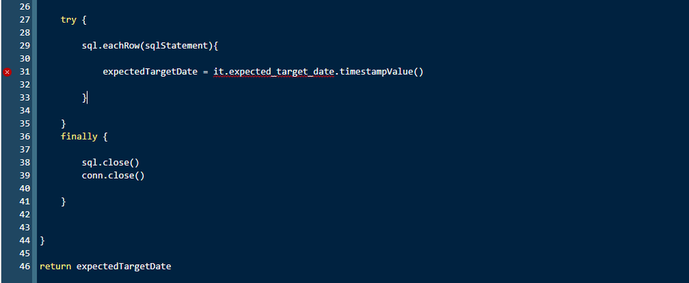

Hi everyone,
The console gives the error below. l need your assistance.
Thanks.

Hello,
I think it is a static compilation error. Scriptrunner does not know if such field exists. Try to execute the code.
If there is an error in the log file kindly paste it here

2018-01-11 13:03:01,293 WARN [common.UserScriptEndpoint]: Script console script failed: groovy.lang.MissingPropertyException: No such property: issue for class: Script36 at Script36.run(Script36.groovy:13)

I would say the objects being iterated over do not have a method or property of expected_target_date.
