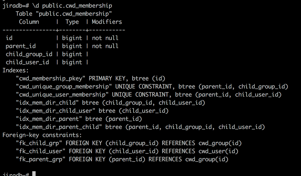

First, I backuped from Jira Cloud.
and I try to restore the data to Jira Server. (postgresql)
How can I handle this problem?
Alexey Matveev
June 17, 2018
Kindly make sure that you followed this guide while migrating from Cloud to Server:
https://confluence.atlassian.com/adminjiraserver/migrating-from-jira-cloud-to-server-applications-938846963.html
Hyunmin Kim
June 17, 2018
I already tried to migrate by followed your link.
I don't know why the difference column exists between server and cloud version of jira.
