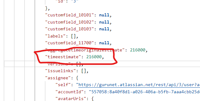

Hi @Trudy Claspill ,
    Actually in the test I was looking for Original estimation of the issue. I want to find certain cases where Original Estimation is a certain value.  I had tried with timeoriginalestimate without success and then tried  timeestimate without success neither. see the result of one of the response:

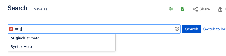

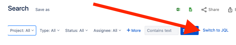

Trudy Claspill
May 6, 2021
Using the Advanced Search functionality ...
...I started typing in "original" and JIRA provided possible matching fields.

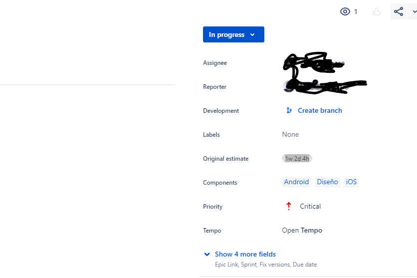

Lucas Sain
May 6, 2021
Just adjusted with same result:
https://xxxx.atlassian.net/rest/api/3/search?jql=originalestimate%3D3600
Lucas Sain
May 6, 2021
GRRRR I know the problem.... I was transforming to seconds and the query is in minutes.... I got it to work using minutes...
