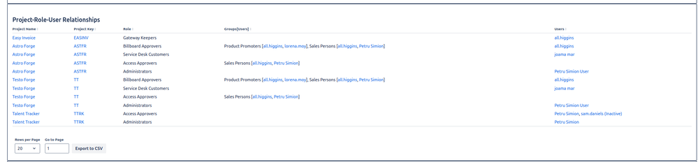

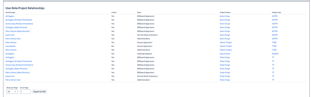

Disclosure: I’m part of the team that built Roles Usage for Jira. It was designed specifically for this kind of visibility problem, including both the Project → Role → User relationship view and the User → Role → Project relationship view, and it also takes into account access paths through groups, not just direct role actors.
roles_dashboard_project_user_role_perspective.pngroles_dashboard_user_role_project_perspective.png
Results are exportable in CSV format.
So if this is something you need regularly rather than as a one-off script, it may be worth looking at a tool that precomputes those relationships instead of walking the REST API live every time.

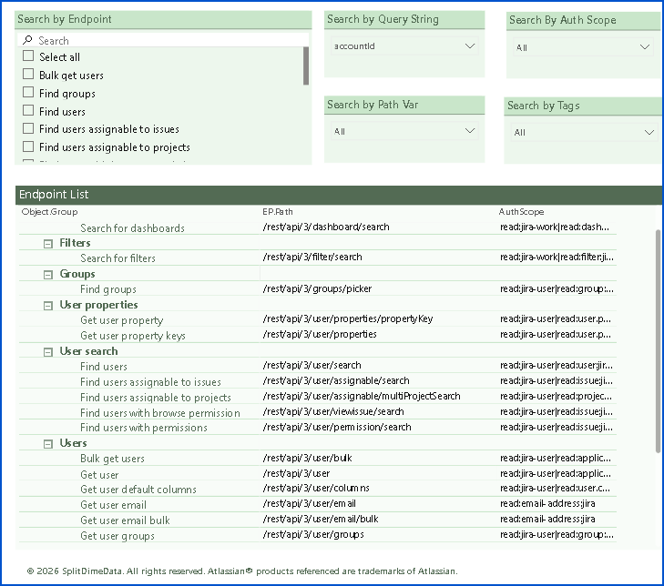

I don't know if these user search endpoints are any faster  - but at least you could do multiple projects at one time.  (or so it appears).
Note -- this screenshot came from my REST API Browser I share with the community from time to time. (free).   It may be hard to spot, but I started with a query paramter search.
REST Browser
