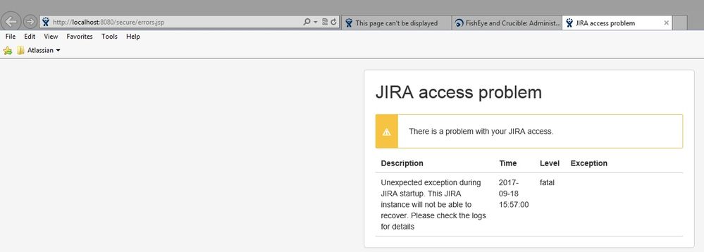

Hi,
I attempted to migrate form the Jira 7.3.6 starter internal database to a postgreSQL as described here:
https://confluence.atlassian.com/adminjiraserver071/switching-databases-802592192.html#Switchingdatabases-differenttype
I followed all steps including updating the JBDC driver to match the postgreSQL revision 9.5 supported by Jira and get the following fatal error message...
I am new to Jira and have not debugged an issue like this and would greatly appreciate guidance navigating the logs the error message refers to.
Boris Berenberg - Atlas Authority
September 18, 2017
You will need to look in your JIRA logs for the exact error message. It will be in the <installdir>/log/catalina.out file.

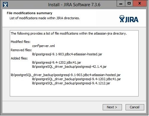

I ran the Jira 7.3.6 installer which made the driver repairs listed in the attached image file and restarted the application which still results in a fatal error.
