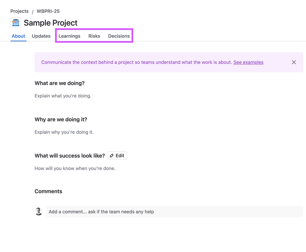

On a final note: it seems you are trying to implement a solution for overall risk management and decision tracking for projects. Atlassian has other ways of managing those built in already in its platform experience, as you can see here:
