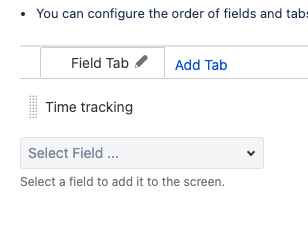

If I create a screen with just the Time Tracking field on it:

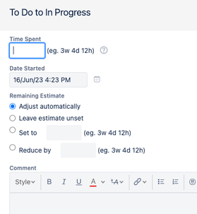

...and I use that as a Transition screen, then when I execute the Transition I see this:
Does that match your configuration and what you see?
You said when you change the remaining estimate it doesn't change "time tracking".

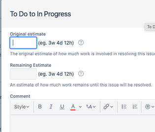

Are you trying to set up a screen where you can use during the transition to log time against the issue? If so you need to add the Log Work field to your screen instead of Time Tracking. Then you will get these fields.
