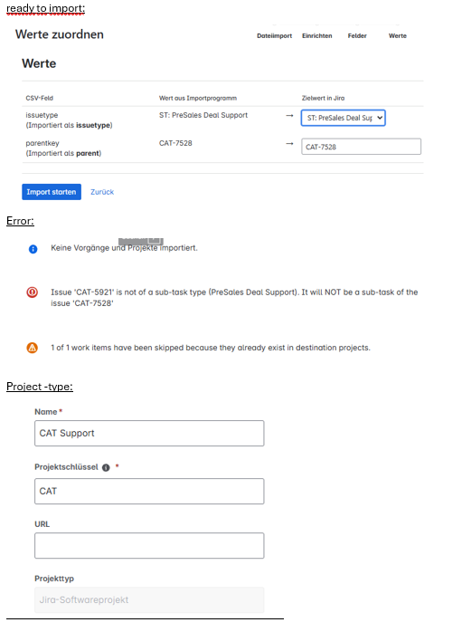

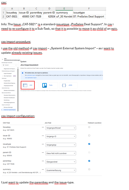

my csv looks like:
issuekey; issue-ID; parent key; parent-ID; Summary; issue-type
CAT-5921; 45083; CAT-7528; 62924; uF_3E Handel; ST: PreSales Deal Support
The idea is that the csv import updates the issuekey "CAT-5921" and set the issue-type to "ST: PreSales Deal Support" and moves it as a child of "CAT-7528".
The import stopps with the information, that the issue CAT-5921 is no sub-task and so it will not be part of CAT-7528.
Should that work?
What have i done wrong?
Is there a tip on how to move several different tasks into different epics?

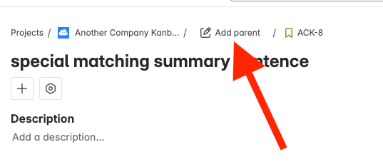

Jira absolutely allow you to set the parent of a standard-type issue to an existing Epic through the UI without converting it to a sub-task.
One method is to view the standard-type issue and click the Add Parent option in the breadcrumbs above the summary.

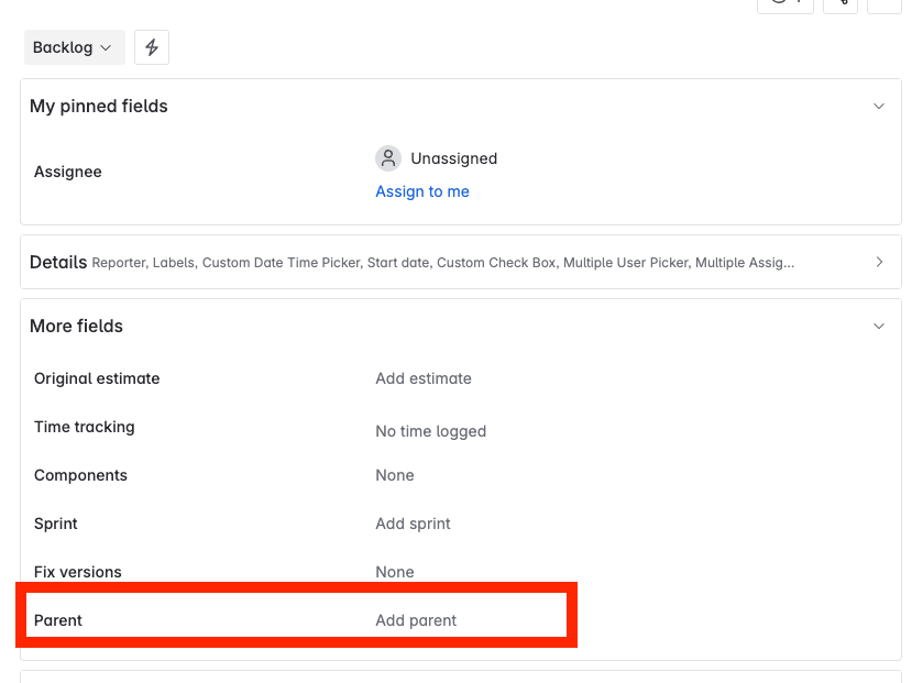

Another option is to ensure you have the Parent field included in the Layout of the issue and then click there to insert the key for the Epic.

With regard to the failure in the import process, we must first know a few things:
1. What type of project does this concern? Get that information from the Type column of the View All Projects page under the Projects > More Projects menu.
2. How exactly are you accessing the CSV import process? Are you accessing that through System > External System Import, or are you accessing it from the Search Work Items screen and selecting Import Work Items from CSV?
3. Show us a screen image of the field mapping you are creating when you execute this import.

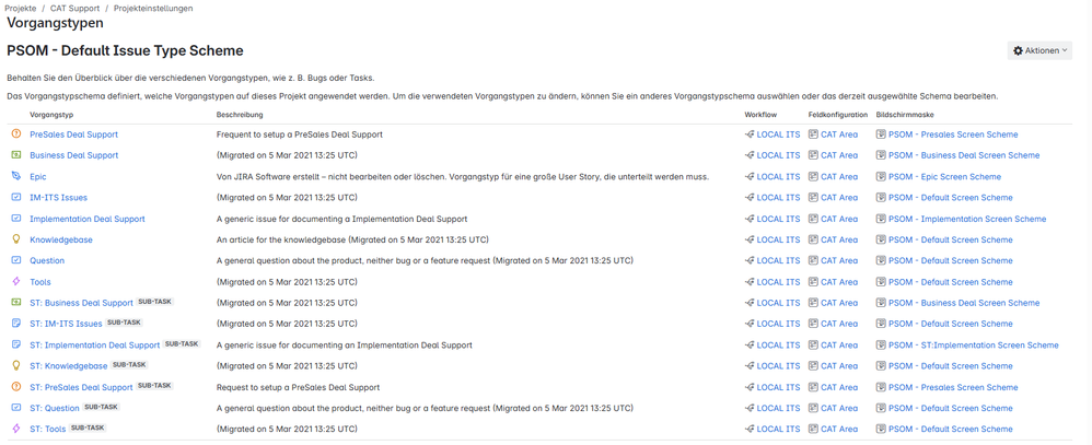

What is the issue type of CAT-7528?
At the time you execute the import what is the issue type of CAT-5921?

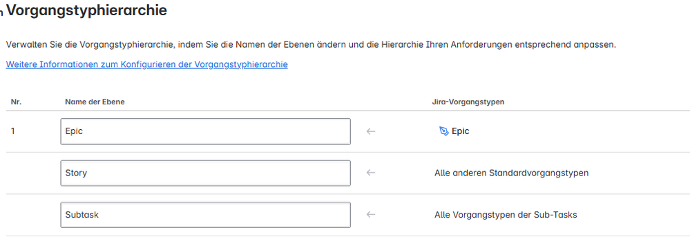

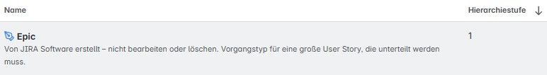

Can you show us the Issue Type Hierarchy for your system from
https://yourBaseURL/jira/settings/issues/issue-hierarchy
Can you show us the Issue Types available to the project as shown through the Project Settings?

CAT-7528 - issuetype = epic
CAT-5921 - issuetype = standard-issuetype (Pre-Sales Deal Support)

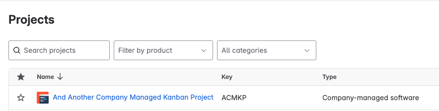

There are two elements to the project type:
Company Managed vs. Team Managed
Business vs. Software vs. Service Management.
The View All Projects page includes both pieces of information.
What you pointed out tells us only that it is a Software project, not whether it is Team Managed or Company Managed. However, looking at both types of projects on my own instance I see that the Team Managed Software project currently doesn't include that field in its Project Settings Details page at all. So I am concluding that your project is Company Managed Software.

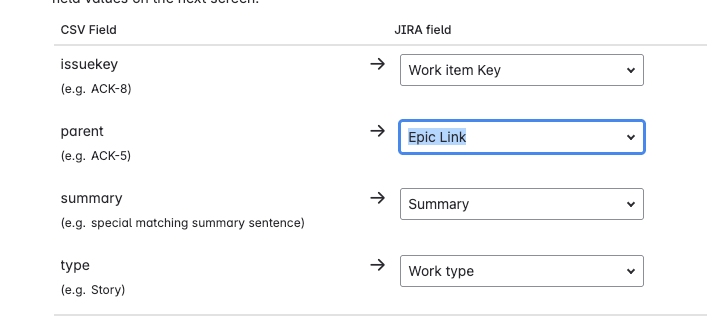

Option 1: Use Epic Link in the field mapping
CSV File:
issuekey,type,summary,parent
ABC-1,Epic,Epic's summary,
ABC-2,Story,Story's summary,ABC-1
Field mapping:

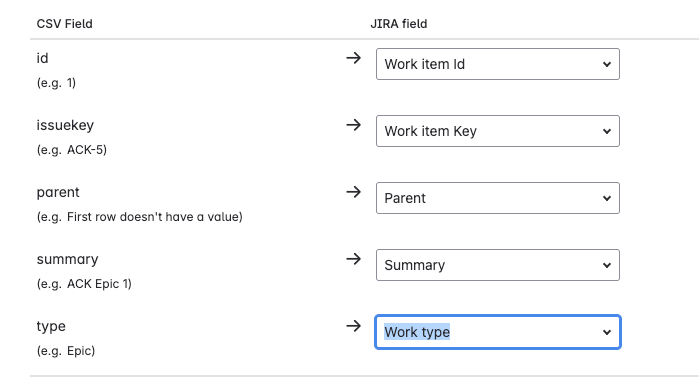

Option 2: use issue ID
You don't have to have the issue's actual ID.
CSV File:
id,issuekey,type,summary,parent
1,ABC-1,Epic,Epic's summary,
2,ABC-2,Story,Story's summary,1
In the "parent" column you put the ID from the "id" column from the row that has the Epic's details. The row for the Epic should be before and standard issue that you want to assign to that Epic. The "id" values can be any unique set of numbers.
Field mapping:

I tried Option1 sucessfully.
The most important point was to link the parent with the "Epic Link" field.

July 22, 2025
I put the answers into the screenshots.
