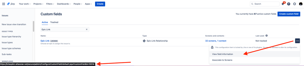

Trudy P Claspill
January 27, 2023
How did you determine that 10000 is the correct ID for the Epic Link field?
You can find the field ID by going to the Settings > Issues > Custom Fields screen. Search for the field. Click on the ... to the right of the field. Hover over one of the options in the context menu. The URL for the option will show at the bottom of the browser screen and will include the ID for the field.

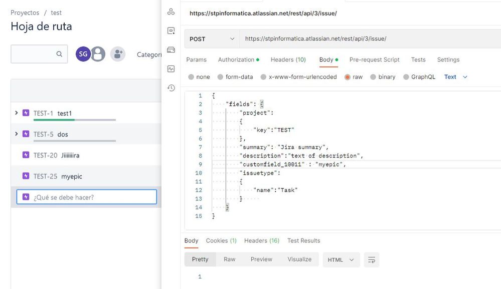

Sergio Garcia
January 28, 2023
Hi,
@Trudy P Claspill I have checked the fields as you have indicated.
Epic Name: 10011
Epic Link: 10014
@Vamsi Kandala I have tried with the two customfields, putting the name "myepic" or the number "TEST-25", but postman does not return anything, I attach capture.

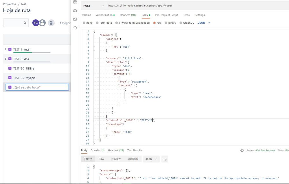

I have also tried with my first code and I get this error.
errors": {
        "customfield_10011""Field 'customfield_10011' cannot be set. It is not on the appropriate screen, or unknown."
Vamsi Kandala
January 28, 2023
Hi @Sergio Garcia
You should use the 'Epic Link' field and pass the Epic key value.
The reason for the error when you used 'customfield_10011' is that the related field is not present in the Create screen of that issue type.  Try adding the field to the Create screen and check again.

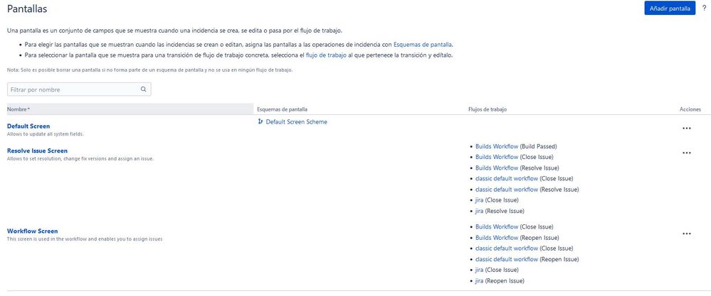

Sergio Garcia
January 29, 2023
Hi,
@Vamsi Kandala You should use the 'Epic Link' field and pass the Epic key value.
Do you mean use it like this? or as?
"customfield_10014": "TEST-25"
I don't see the create screen, these are the screens I see.
