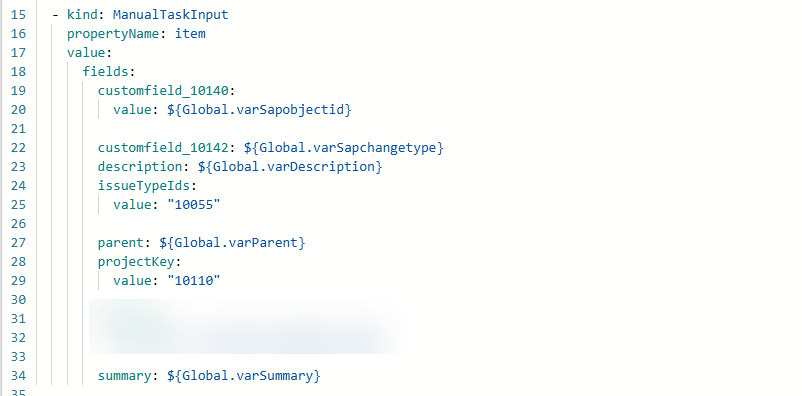

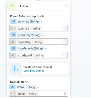

I am unable to create a Jira Story from one of my Copilot Studio topic flows.
It is not clear whether the problem is with the Jira API design or with Copilot Studio itself.
I am specifically stuck on how to pass the summary and description fields when using the Create a new issue (V3) action.
The documentation and in-product guidance are very limited, which makes it difficult to understand and resolve these errors.
Can someone please help by explaining how to pass the bare minimum required fields, such as summary and description, in the Item payload so that a Jira Story can be created successfully?
Thanks !
