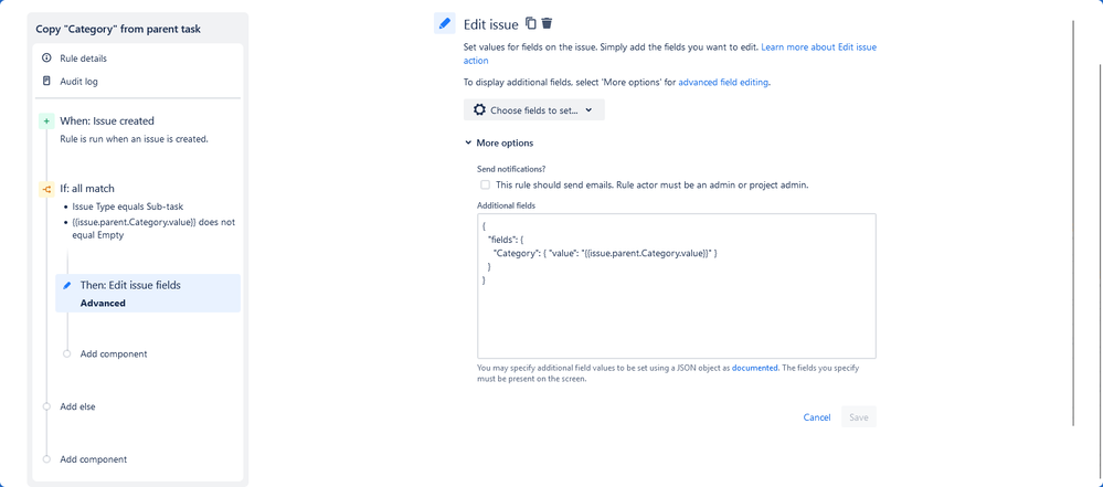

Tomislav Tobijas
September 4, 2023
Hi @Erik Mathijs

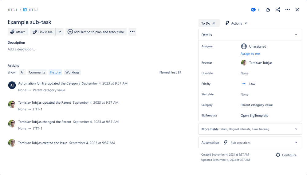

You can construct something like this:2023-09-04_09-42-40.png
You'll need to use Advanced fields section within Edit issue action and you can use the following JSON:
"fields": {
"Category": { "value": "{{issue.parent.Category.value}}" }
This should copy any "Category" value that is set to a parent issue (if it exists).
Hope this helps.

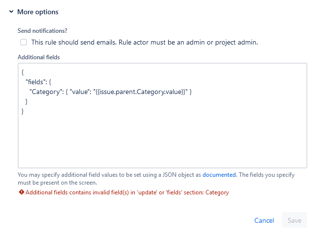

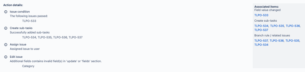

Hi all,
I am facing the same problem and when using the JSON, I get the following error message: Additional fields contains invalid field(s) in 'update' or 'fields' section: Category
I would appreciate some assistance with this case.

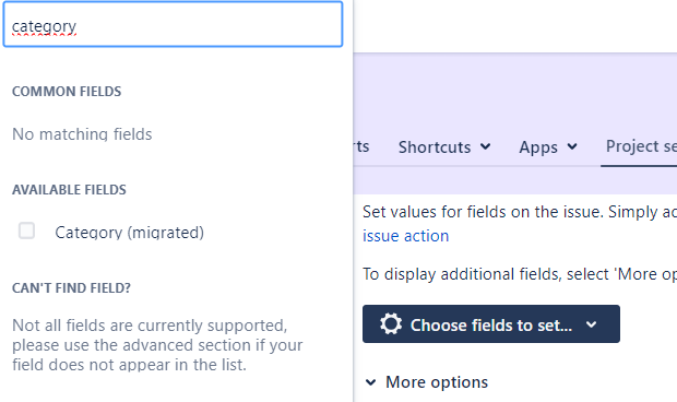

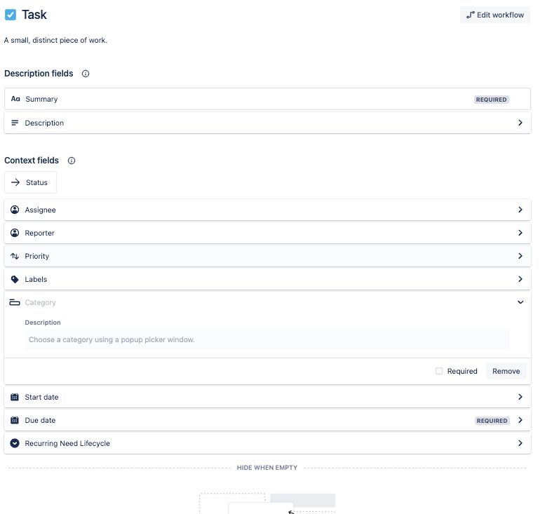

Justina Bülow
September 12, 2023
Hi,
Yes, it's a Jira Work Management project and a team-managed project.
The subtasks are created by automation and both parent and subtasks contain the category field.
The only Category field I can choose is showing the wrong values, so it can't be the correct field.
I believe we messed up something with the field, but I'm unsure how to solve it.
Thanks for your support.
Best,
Justina

Justina Bülow
September 12, 2023
PS: I believe the field is preset, as I can't change the field at all.

Hi @Justina Bülow

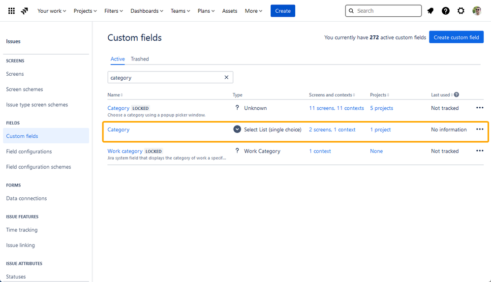

I think I've managed to replicate this error you're experiencing.2023-09-12_12-54-27.png
Basically, this might happen in case you have more than 1 field named "Category".
From the "Edit issue" action that you've attached here, I suspect that's the case (as you cannot, at the moment, select the system "Category" field from that dropdown).
Can you please navigate to Settings > Issues > Custom fields and check if that's the case? It should look something like this (note that the highlighted field is the custom field created by a user, and the one with "Locked" status is a system field):
In order to 'fix' this - to be able to use the provided JSON within the automation action, please rename all custom fields that are named "Category".
If that did not help, or if you mustn't/shouldn't rename those fields, I can try to find some other solution that actually uses system field ID instead of a name.
Just a note - I've tested this on a company-managed project.

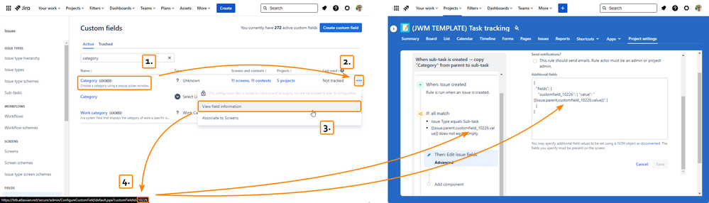

Tomislav Tobijas
September 13, 2023
Then, you can basically use the following format customfield_ID instead of "Category" string/name.
To find the ID of the system "Category" field navigate to Custom fields page under Jira administration and search for the term "category", and follow the steps below:
  1. Find the system "Category" field in the list (the one with type = Unknown and where there is a small label "Locked" next to a field name).
  2. Click on the 'more' button next to a field name.
  3. Hover over any of the available options.
  4. At the bottom of the page, you'll see a URL to which you'll be redirected once you click the link, and in the URL you should see a field ID.
Once you find the ID, go back to the automation rule and just replace "Category" string with customfield_ID where the ID is the number you've found in the step 4.cf_ID.png
I've tested this by having 2 fields named "Category" in the custom fields list, and automation worked as expected. Also no errors/warnings were stated when trying to save/publish the rule.
Note that it might be recommended to not have two or more fields with the same name (whether we are talking about system or custom fields) - due to easier administration and also to not confuse end users. That's why I suggested renaming the custom field in my previous answer.

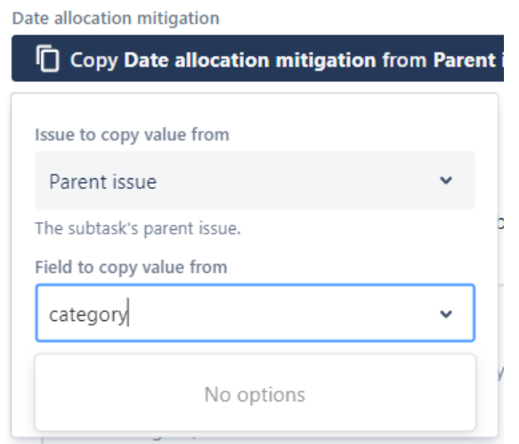

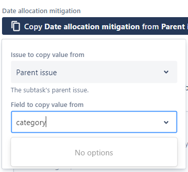

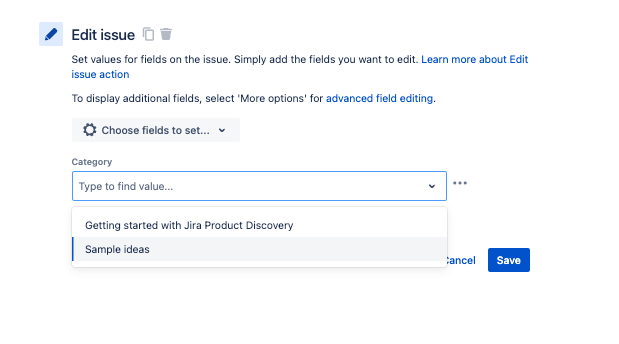

Erik Mathijs
September 4, 2023
Hi @Fabio Racobaldo _Catworkx_ ,
This video is helpfull but the category field in jira work management seems to be a special field.
September 4, 2023
please share a screenshoot about that field on creation
Erik Mathijs
September 4, 2023
In jira work management i have the field category
i want to copy the category field from the parent to the subtask when a subtask is created.
In the automation rule i create a branch
In the choose field to set the category field is not available
and it is also not available on the copy field from parent (for getting this i selected another field to try getting the parent field category
