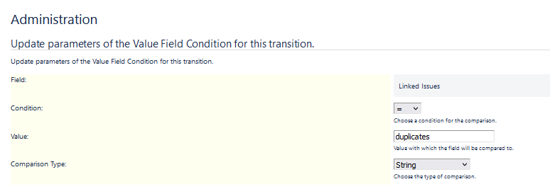

I am trying to create a condition in workflow, that will only allow the issue to transition to done, if the linked issue is set to duplicates
I have edited the workflow and created a condition value field
Field: Linked issue
Condition: equals
Value: duplicates
Comparison Type: string
But it will not let me transition any issues, I am not sure why it’s not working, I have not had any issues using conditions in workflow before.

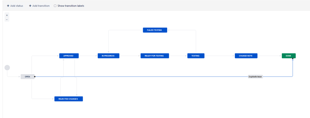

Hi John
The transition with the problem is Duplicate Issue going from open to done.

Ah, I think I see it - the Linked Issues field is for an actual issue key like ABC-123. I think you are looking for the issueLinkType field, which I don't believe is available in the Value field condition.
You will need an add-on such as JMWE or ScriptRunner to be able to do that.
