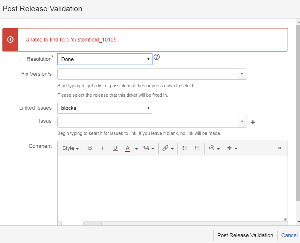

Ok. I found it and added a post function and it is working now. But it looks like I broke something :( When I try to move the issue into one of the workflow steps I am getting an error.PNGerror.

That looks like a script or add-on is trying to validate something that no longer exists.

Do you think I have removed two post-functions (see below) that are causing a problem? If so, how do I fix this?
 1. The content of the field Closed By will be purged. (not sure how to add it again, any help will be appreciated).
2. Copy Value from Other Field (JSU)
*  Copy Field: Assignee to Closed By, overwrite
Nic Brough -Adaptavist-
January 10, 2018
No, removing post-functions will not add a function that looks for a custom field that does not exist!
Have a look at all the other post-functions and validators you have on that transition.
