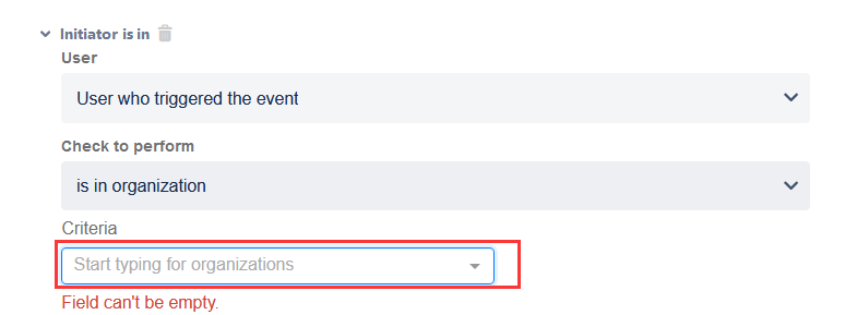

i would like to set up a automation to work like this:
when a comments author is one from the customer group i set up, the automation will trigger the status change. how i should compare the comments author with the customer group?

I believe that, if you set the rule to trigger on the creation of a new comment, you can use the "User condition" to check the group of the user who triggered the event (the comment author). Within the "User condition", you would set the "User" to "User who triggered the event", the "Check to perform" to "is in group", and the "Criteria" to the customer group you created.

thank you for the help. the group is a customer group ( i create a customer organization for the group) . and seems i can't find it in the back-end.  do you know why? or should it be solved in other way?

I believe you would still use the "is in group" check. But, if it still does not appear there, I'm not sure what the cause would be.

in the automation rule i create , only below condition is not passed. that's why i think the member i added to the group yesterday is not effective yet.....
User condition
The following issues did not match the condition:
Tiffany Li
June 1, 2022
the issue figured out. 'in organization  ' works. i did not find it just because the organization name i input is not same to the one i created...it works now. thank you
