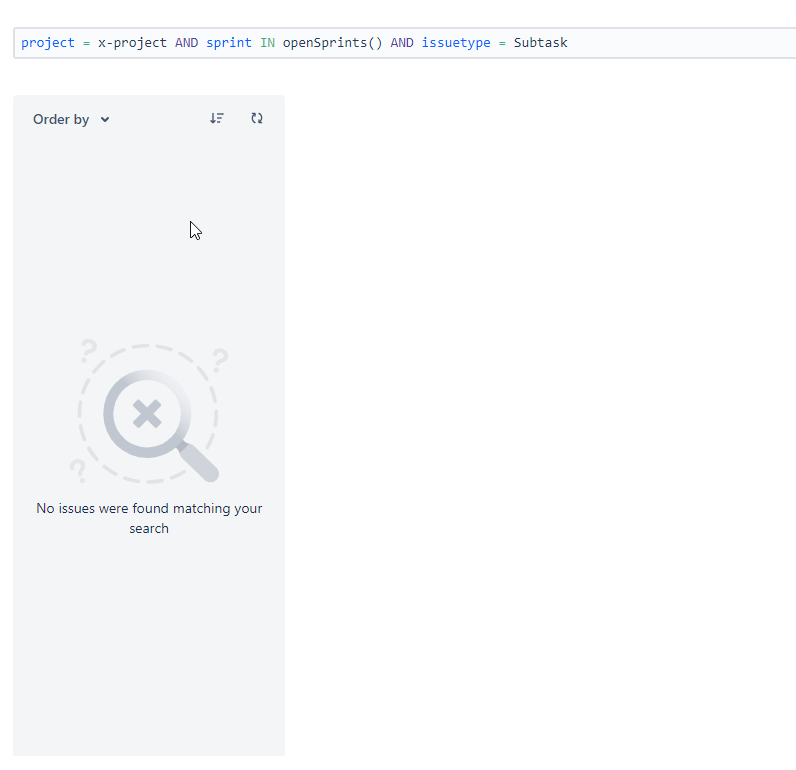

hello, i use JQL to filter my ticket
use this JQL
project = x-project AND sprint IN openSprints() AND issuetype = Subtask
but in real board, there are not subtask exist in open sprint
result

Hi @digital solution
Is that the correct "Subtask" wording? There's often two Sub-task Issue Types in Jira I find...
  • Company-managed - Sub-task
  • Team-managed - Subtask
Try changing Subtask > Sub-task (it should be visible when auto-completing the search phrase), and see if this works.

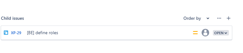

digital solution July 30, 2023
yes already correct issue type

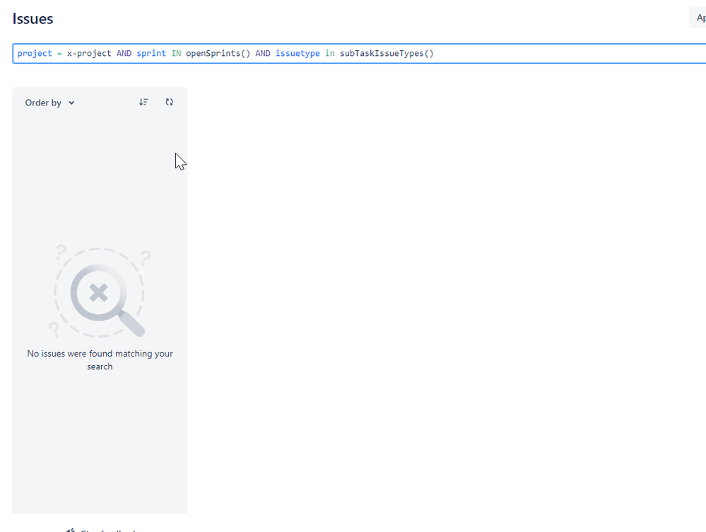

also i try your query
use
project = x-project AND sprint IN openSprints() AND issuetype in subTaskIssueTypes()
same issue, no tiket shown
Looks like it's a bug/feature request - see:
^ Your options would be to either...
  • Move to a Company-managed Project as @Evgenii suggested or...
  • Find a workaround, likely using Automation to populate another field you can search by
If you did consider using Automation, this is what I'd do:
  • Create two rules, one triggered by sprint starting, the other sprint completing
  • Have the rule locate Sub-tasks related to the sprint which is starting/completing, and populate a label as "Open Sprint" or "Closed Sprint"
  • Build search queries which include the label parameters in them
^ Not ideal, but a partial workaround at this point :)
