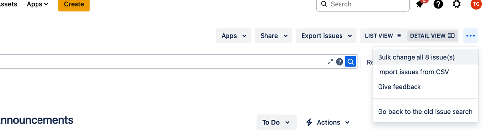

  2. Click ... > Bulk change all x issue(s)Screenshot 2024-06-24 at 16.51.57.png

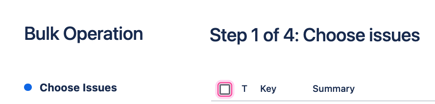

  3. Select all desired issues by clicking the top checkboxScreenshot 2024-06-24 at 16.52.49.png
  4. Select Transition issues and follow the UI prompts

You can filter that 400 issues from issue navigator and click 3 fot icon. With bulk change all option, you can transition your issues to cancel status.
