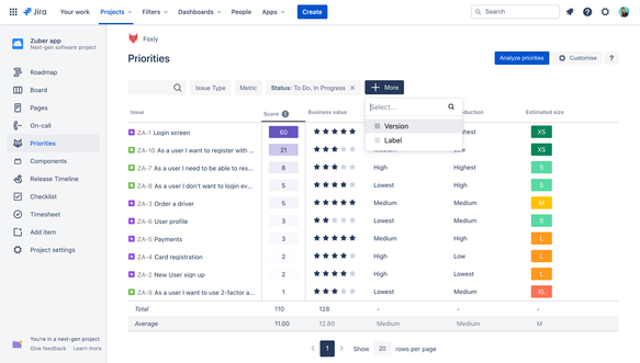

Nikki Zavadska _Appfire_
July 28, 2020
Hi @aarti rajput
if you want to save yourself a headache with setting this up you can also have a look on other available plugins for backlog prioritization.
We recently launched Foxly - Backlog Priority Scoring for Jira Cloud that gives you the option to choose and customize your prioritization method - including WSJF and you can use filters in the app to get the backlog view you need and want to prioritize....including filtering by issue type like Epics you mentioned.
PS: The calculated priority score is also available as a custom field so you can JQL it or use in Automation for Jira.
