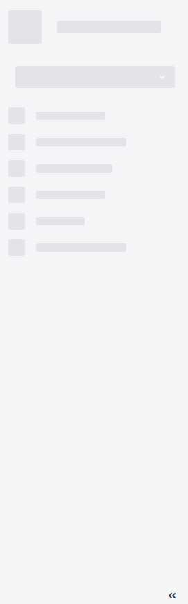

And the left column of the project is empty
We have performed the refactoring of the index operation, but this does not solve the problem, what is the cause of the problem
