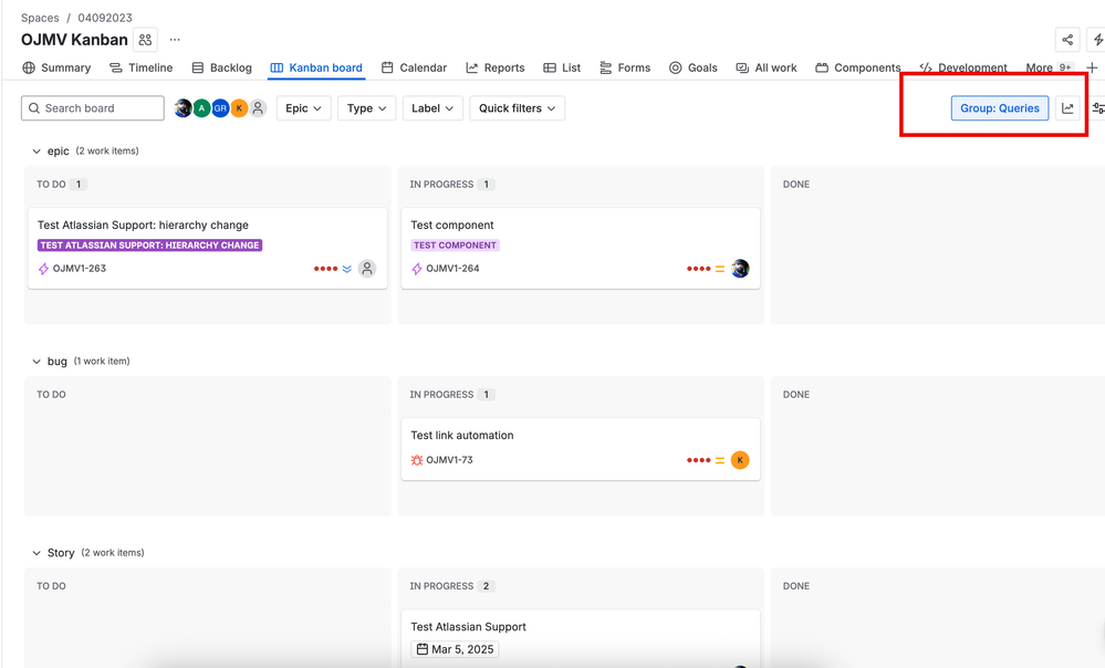

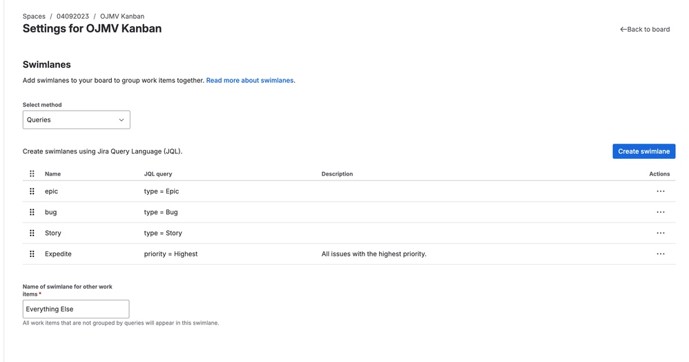

Karan Sachdev
January 15, 2026
Hey @Trudy P Claspill
It's working as expected on my end. Here are the screenshots from the board and swimlane configuration page:
Thanks!

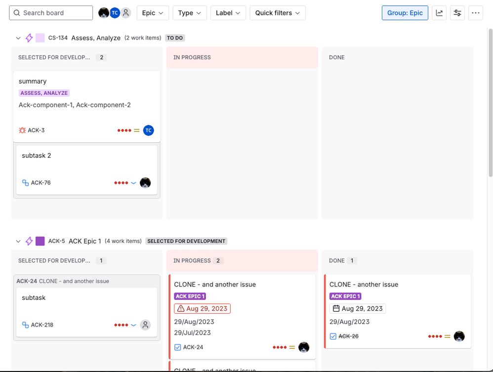

Trudy P Claspill
January 15, 2026
I don't think that is what was asked for.
On an agile board if you choose the Epic option for Group, then you get a swimlane for each Epic and the swimlane contains cards for the child issues of the Epic.
I believe the request is to be able to do the same thing by selecting the work item type above Epic; i.e. Group by Initiatives would create a swimlane for each Initiative and the swimlane would contain cards for all the child items under the Initiative.
