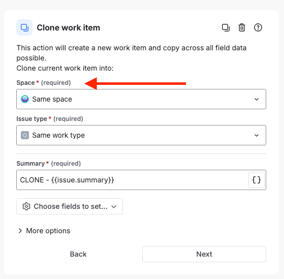

Hi! Thank you. That's using deep clone?
Trudy P Claspill
November 11, 2025
No, the Clone action in native Automation allows you to select the destination project/space.

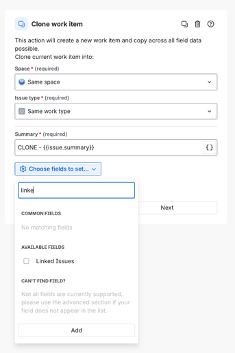

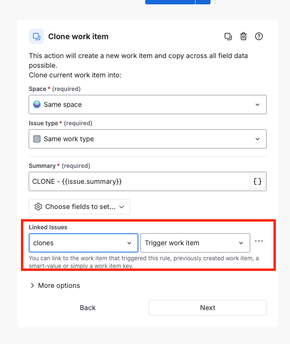

An extra help: how can I ensure that the cloned issue is linked (cloned by) to the original?
John Funk
November 12, 2025
Add the Linked Issues field to the fields when you do the Clone. Change the link type to what you want and the second part would be Trigger issue.
