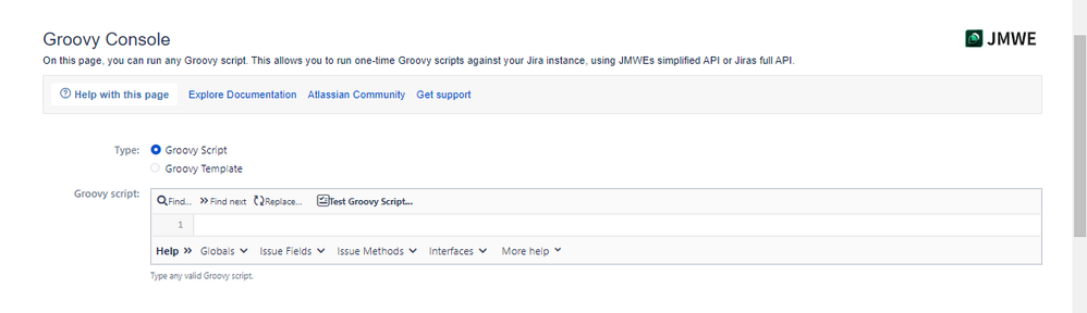

It looks like it'll help our requirement using above script in JMWE addon, but where do i need to add above script as in my env showing groovy template PFB.
it will be helpful if you can give right script to add.

Channakesa Chindanur
August 10, 2023
O/p for above script, but still not reflecting in my Jira issue

David Fischer
August 10, 2023
As I mentioned earlier, this script is meant to be used either on a workflow post function such as the Set Issue Fields post function, on the transition where you set the End Date field, or on an event-based action that listens to changes to the End Date field.
Please read the JMWE Server/DC documentation for details.
