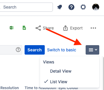

If you click on the button on the right (shown below) and select List view, that will show the output in Columns. Then you can click the button below it labeled Columns and select which fields you want to see in the output.

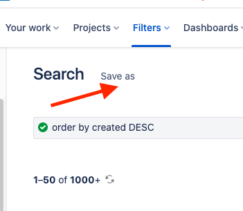

When you have the search criteria and the Columns set the way you want, click the Save As button, and provide a name for this filter.

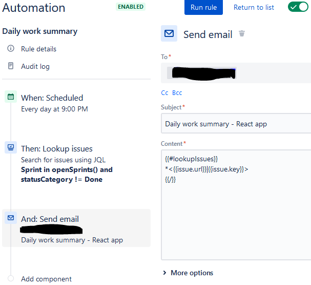

I tried to recreate the example from the link above. The log says 'success', please see the attachment.

Yes, it is the third thing I noted: smart values...
When using Lookup Issues, the scope is the lookup, and so you do not use the {{issue... or {{triggerIssue... prefix. Instead just reference the attributes like this:
{{#lookupIssues}}
* {{url}}
Please adjust that to the format/markup you wish.

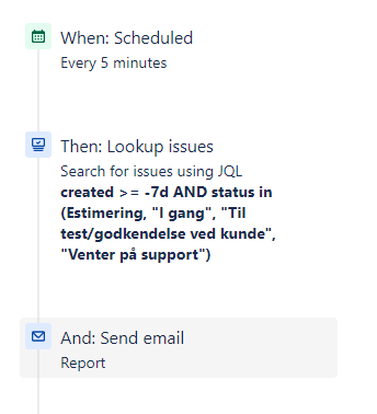

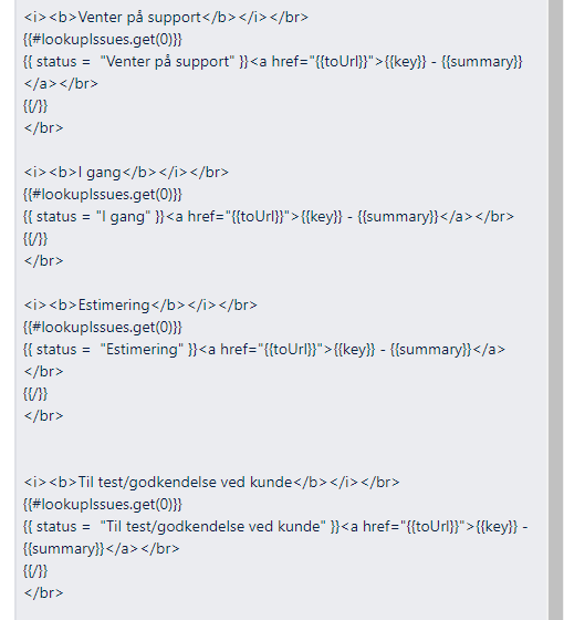

Hi @Bill Sheboy
I followed your last steps you wrote. But I can't get the right status under the right "status header" and I can't show more than one issue on one specific status...
I saw this get() method but didn't help me because it looks at the index of my filter.
First thing, get() returns a specific single entry from a list. With your get(0) that would only look at the first issue in the Lookup Issues result (if there are any issues), so it is unclear what you are trying to do.
Next, please look at the example I posted and look at this post on filtering. Your expression does not match either for filtering a list.

HI @Bill Sheboy
I tried that from the link you send, but it only gave one issue and after I wrote I tried the example above in the post for the second time and it worked well.
Thanks for the input :)
