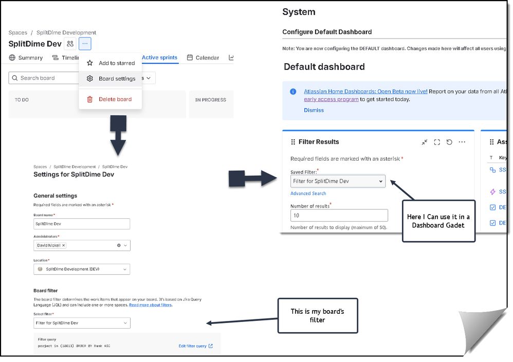

David Nickell
January 13, 2026
I think eveyone is nibbling around the edges without enough detail (as am I) ... but I will add to the conversation (I hope):
  1. Determine the JQL your board is using though the board settings
  2. Go to the Filter Navigator and create a filter with that logic.  Call the saved filter anything you want  (e.g. "My_Favorite_Board_Filter").
  3. You can use that filter in any number of places now (including within your board if you want to make sure you don't get out of synch)
If this doesn't help -- perhaps you can provide some more specifics.  Thanks

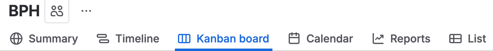

This is an accurate representation of what's happening, but the UI is very misleading. e.g. i create two boards and give them specific names and specific filters. The names of the boards appear at the top, and the "tabs" (Summary, Timeline, Board etc.) appear below it, as shown
This gives the misleading impression that everything on this screen will use the filter associated with the board, but actually only the kanban board in this case uses the filter. even if you create 10 such boards, the content for the other "tabs" is exactly the same in all of them.
yes, you can create additional filters to use for the List for example, but whatever filter you choose in one of those boards shows up on all the boards, showing, quite clearly, that rest of the tabs are quite independent of the "board" you thought you created.
