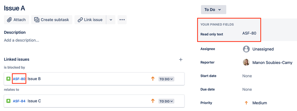

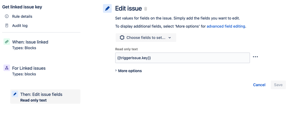

Does the following rule meet your needs?
Looks like it does what you need:
Hope this helps!
- Manon

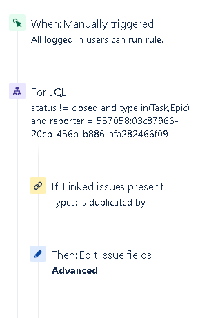

@Manon Soubies-Camy  thanks for the reply, but not quite.
i need to have that update on all the existing issues in the system that are already linked.
The trigger cant be for a current linking that takes place.
I have a manual trigger, that for BRANCH ISSUES: jql for epics + tasks != closed status.
i cant use another branch of linked issues within the original branch and i have to use the original branch to cover the existing issues.
thats why i wanted to use the json approach to pull information into the issue's UI.
ben friedman
May 27, 2021

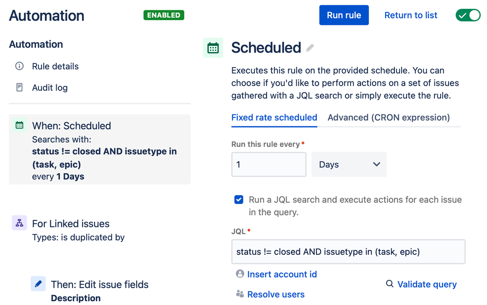

So would it work if you used a scheduled trigger instead of a manual one? It triggers the rule from a JQL query and then you can add a branch. You also can manually start the rule by clicking on "Run rule". Not sure to understand the functional need behind your question so my suggestion may be irrelevant.
ben friedman
May 29, 2021
actually, the JQL under the scheduled should do the trick i think!
Thanks :)
