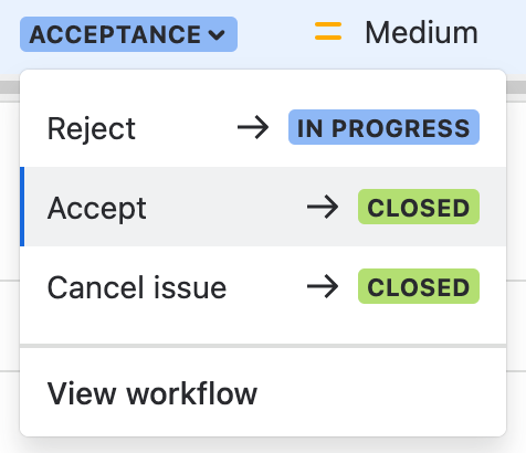

Our Jira allows two "Closed" statuses: "Accept" and "Cancel issue". But acli doesn't seem to have a flag that can specify which.
If I run "acli jira workitem transition --key $WORK_ITEM_KEY --status Closed", I get "Failure: $WORK_ITEM_KEY can't be transitioned: io.atlassian.micros.clibackend.exceptions.InvalidPayloadException: Please describe why do you want to Cancel this issue."
If I run "acli jira workitem transition --key $WORK_ITEM_KEY --status Accept" instead, I get "Failure: $WORK_ITEM_KEY can't be transitioned: No allowed transitions found for given status".
How can I proceed?
