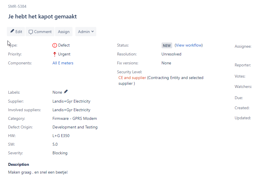

In my workflow after creating an issue (status new) i must be able to accept it. For this i made a transaction. I got all the permissions necessary  but still i cant see the button.
i found a lot about workflow integrity but cant find the integrity checker except the lexorank management integrity checker but that had no problem)

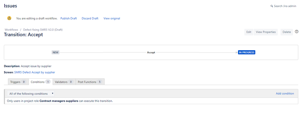

Erik Lindeman
September 5, 2019
yes i did but have all the conditions, also tried it without conditionsimage.pngimage.png

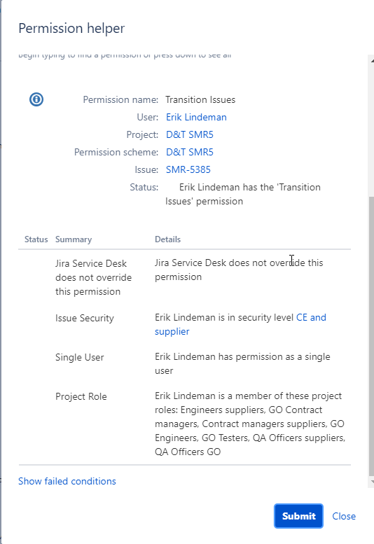

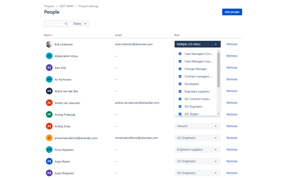

Erik Lindeman
September 5, 2019
got that one too :-)
Erik Lindeman
September 5, 2019
and indeed the permission helper: all good it seems
Robin Weiß
September 5, 2019
If you also checked "Show failed conditions" I can't think of a source of this problem.
