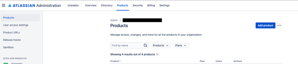

Trudy P Claspill
February 8, 2023
You may be a Site administrator but not an Organization Administrator. You would need to be an Organization Administrator to add a new Product to the Organization.
Can you show us what you see on that Products screen? An Org Admin should see something like this:
