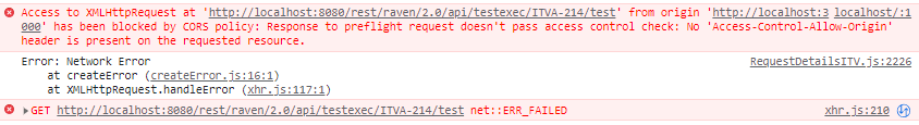

I tried to make a get request with axios. I am implementing Xray in my project.
var config = {
       method: 'get',
       url: 'url',
       headers: {
      'Authorization': 'token',
      'Content-Type': 'application/json',
       data : data
        axios(config)
        .then(function (response) {
         console.log(JSON.stringify(response.data));
         .catch(function (error) {
          console.log(error);
I added my app to allowlist in Jira for avoiding the following issue:
This solution works fine for Jira Rest APIs but not for  Xray Rest APIs.
I tried to modify headers.

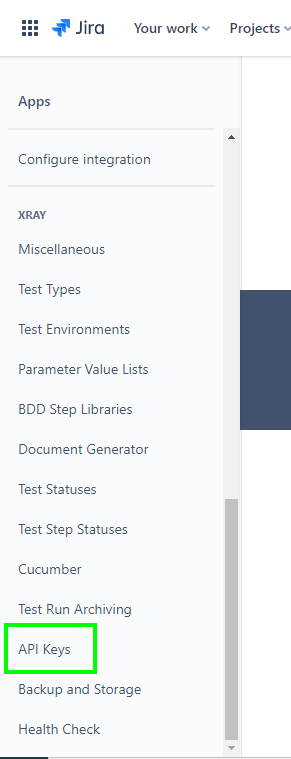

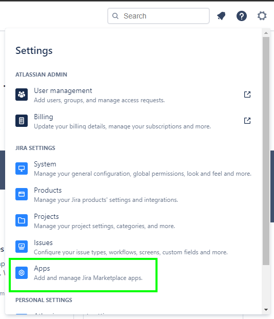

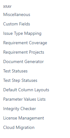

Stefan Salzl
April 2, 2022
Hi @Martha Sanchez
the settings in your screenshot are the project related xray settings. API tokens are set in the xray app administration (as far as I know this needs admin permission).
if you click the jira settings/admin button (in cloud this is in the upper right corner) and then choose „apps“ there should be a separate section for xray (I can send a screenshot later as I‘m nit at my notebook currently).
