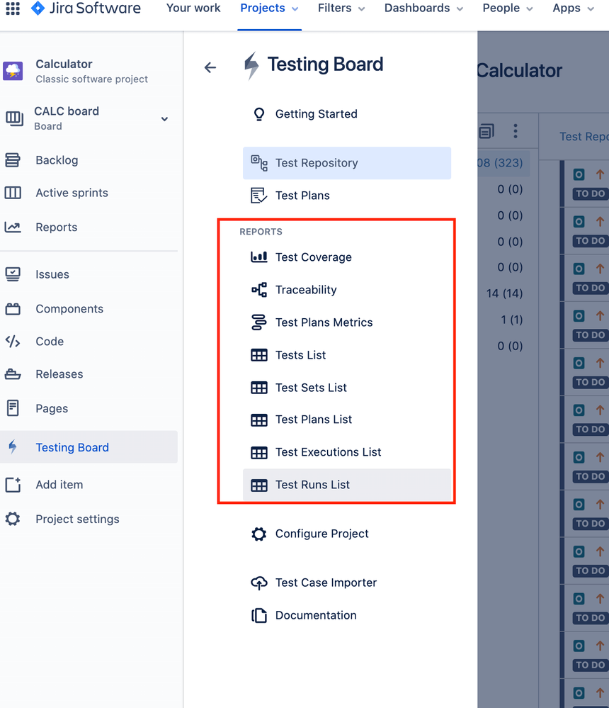

Sergio Freire - Xblend
November 11, 2020
What do you see here?

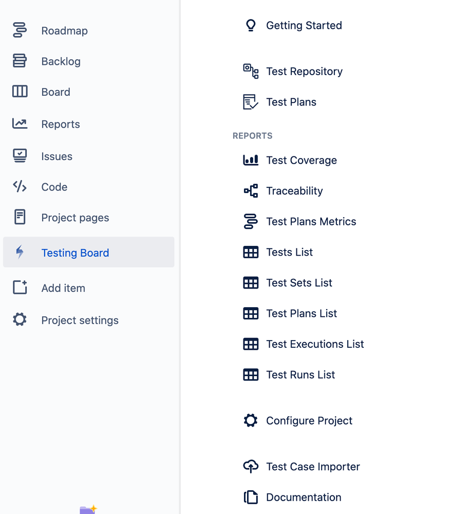

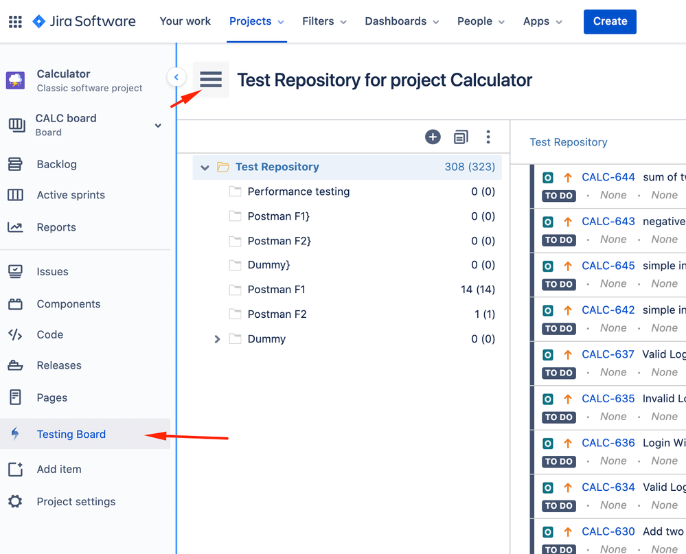

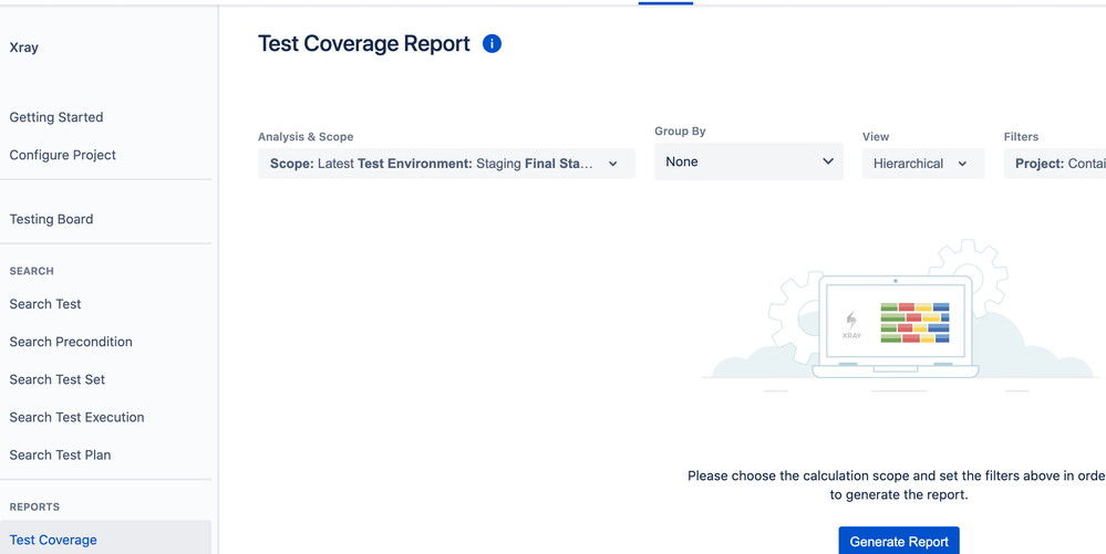

Desislava Stoyanova November 11, 2020
I do see some reports here, however not really understoodable. I don't see any bug report, though?Screenshot 2020-11-11 at 23.24.52.pngScreenshot 2020-11-11 at 23.26.17.png
November 12, 2020
Hi @Desislava Stoyanova ,
These are the reporting mechanisms that Xray provides, which include reports, gadgets and more.
Well, I don't know exactly what you mean and want to achieve exactly with the "bug report" you were looking for.
If you aim to build a report based on bugs, you can use for example Jira standard gadgets for that in order to list, for example, Bug issues. You can also see that in the built-in Traceability Report or in the Test Plans Metrics report, for example.
Hope this helps.
Regards
