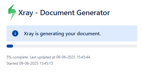

I am facing the same problem.. Its stuck at 5% in Edge browser and at 0% in Chrome browser. What is the workaround for this?

This issue has resurfaced the only difference is progress is stuck at 5% . xray.png
