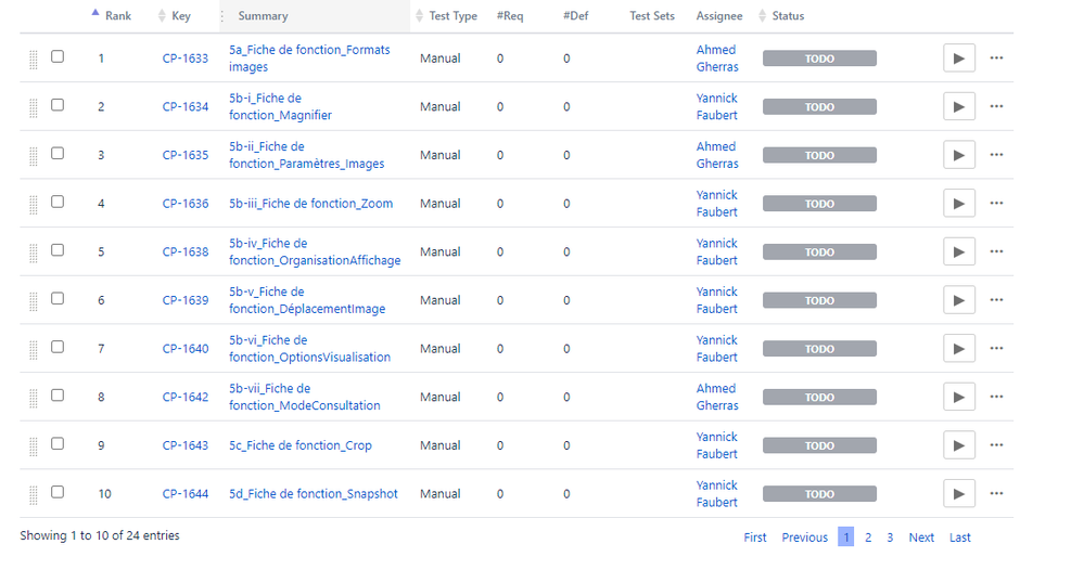

For exemple I have put the jql search :
Issuetype = Test AND issue in testExecutionTests("CP-1959","", "yfaubert","false", "")
It returns anaything while I have some assigned to the user : yfaubert (attached in the file)Capture d’écran 2021-04-09 120900.png

The issues itself are all assigned to user 'yfaulbert'?

1) But in my case, we have only one testexecution and in this testexecution we have several testcases which are assigned to different tester. In this case, how can we know the number of test assigned to each tester?

In the JQL function, it filters by the Test Run Assignee, which is the user that actually run the Test and can be different from the Test Assignee and the Test Execution Assignee.
So, if you are aware of this and still the result is not right, it is best to please contact the Xray Support (http://xraysupport.xpand-it.com ) so that we can request additional information and help further.
