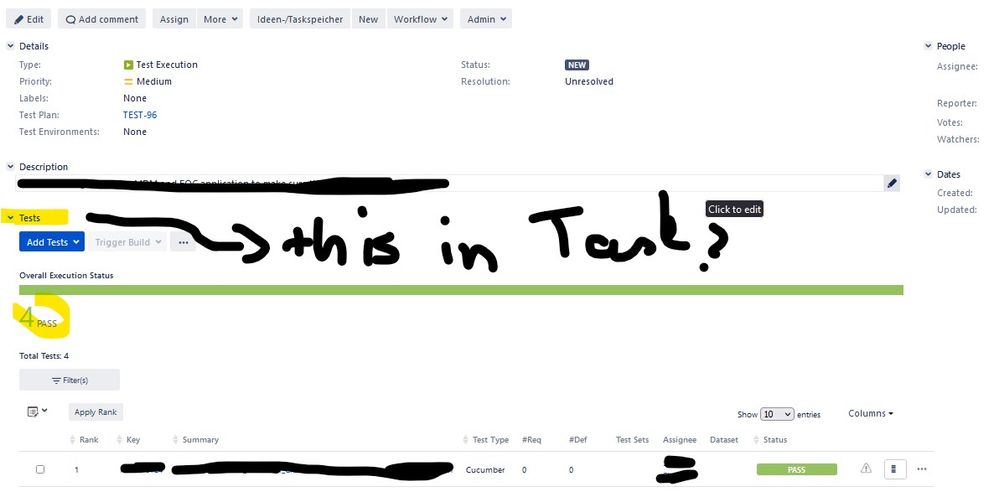

I like to see the Test section into the Issues types "Story", "Task" ect., like it will show in the Testexecution.
The Target to see the current Teststatus in the task issue directly an be able to open a Test over the task. How I can config it?
In attachment I try to show you, what I mean:

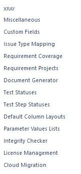

Unfortunately, I can't see this option, in Project and in the admin area. Do you have an explanation for that?
Project:
Admin panel:
Should I have to config an other thing before?
Manoj Gangwar
June 21, 2023
Hi @Toni Theophil ,
Please check under admin
It should be available under Issue type mapping or Requirement coverage.
My license is expired so not able to check.
Toni Theophil
June 21, 2023
Found it:
I had to activate first the Project for the Requirement under "Requirement Project" after that Jira take the issue type which definied unter "Issue Type Mapping" as "Requirement Issue Types".
So short summarized:
Activate Project which the target is: --> "Requirement Project" --> Then define the Issuetypes under "Issue Type Mapping" in "Requirement Issue Types"
