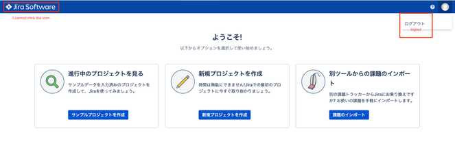

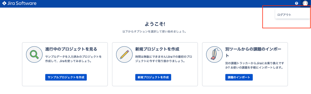

Wang, Lan 1
April 16, 2020
Thanks for your quick response. It does not work for me.
When I login as the administrator, there seems only logout option for me, as is shown in the attached screenshot.
I really need your help

Wang, Lan 1
April 16, 2020
Hey, Alexis. Actually, I am the administrator of this site. And after installation, I have registered the login user as admin. It is a little wired that the admin only has a logout option.
Could you please tell me how to reset the admin account? or any other ideas?

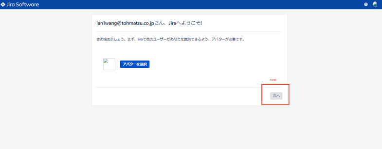

Wang, Lan 1
April 16, 2020
I will translate Japanese to English.

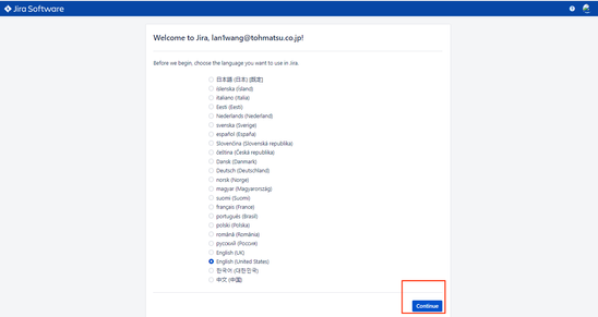

Do you know any ways( CLI or GUI) to check if admin is successfully created ?
first, When I log in the site as admin, I am asked to select language.screenshot 20.png
Even after selecting English, and hit 「Continue」, still comes with Japanese(a little wired), asking select an icon. I goto next
Then comes the welcome page. I tried to click on the icon on the left top. but there's no reaction. All I can do is create a new project or logout. I can successfully logout. the login user is the admin. But I cannot create a new project successfully. Please help me out.

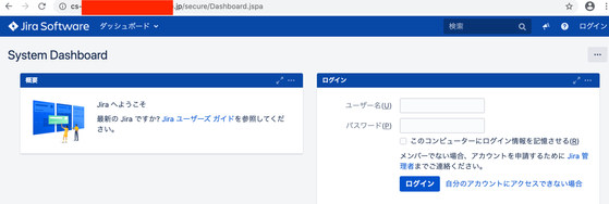

What happens if you remove the "welcome.action" from the URL on your last screen ? it should redirect you to the Jira Dashboard.
Wang, Lan 1
April 16, 2020
if I remove the "welcome.action" and hit enter key, it goes to the following screen.
After log in as admin, it goes to the language selection screen of my last post.
What happens with my admin user, it seems that my admin user does not have any privileges.
