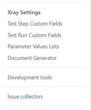

andieri
July 5, 2022
Hi Stefan!
I have the same problem in my test tracebility.
I've tried to set up the option, that you mentioned, but I have no clue where is that.
I'm an admin on the project, that I use. I can see a lot of options in the list on the left side, however there is no options for Test coverage.
Could I ask to attach a screenshot, to see the related link for the Test coverage.
Best regards
Andrea Kovacs

andieri
July 5, 2022
Hi Stefan!
Thank you for the quick answer. :)
I tried to find the link for Test Coverage setting, and then I realized that we have server edition of XRay, so maybe the configuration options are different.
I attach a screenshot.
Thanks again
Andrea

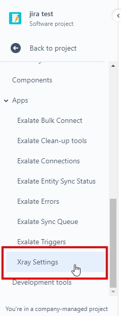

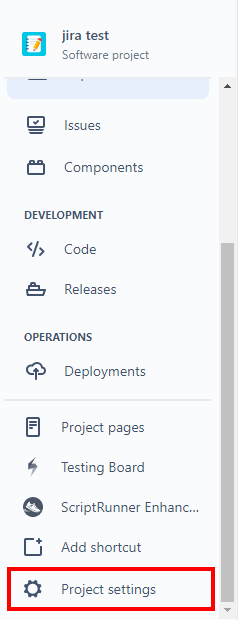

Stefan Salzl
July 6, 2022
Hi @andieri
In this case requirements coverage can be enabled by opening the project settings (this should also be in the leeft bottom corner) and then clicking the "Actions" button in the right upper corner.
The following link describes it very well:
https://docs.getxray.app/display/XRAY/Configuring+a+Jira+project+to+be+used+as+a+Requirements+project#ConfiguringaJiraprojecttobeusedasaRequirementsproject-EnableXrayRequirementCoverageusingtheProjectAdministrationPage
Best
