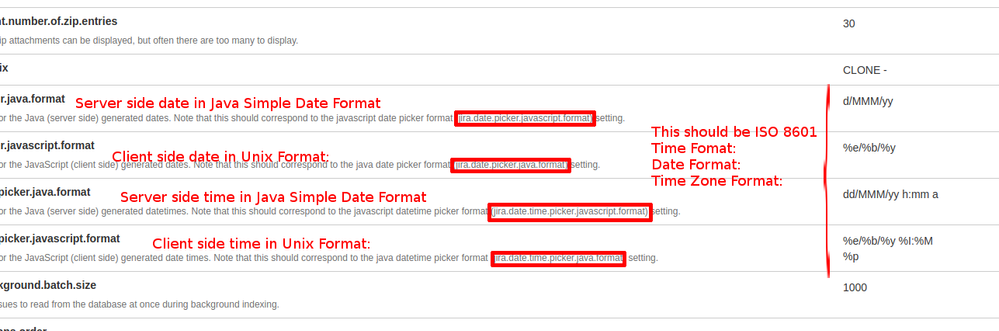

# jira.date.picker.java.format
English default:
This part is only for the Java (server side) generated dates. Note that this should correspond to the javascript date picker format (jira.date.picker.javascript.format) setting.
German translation:
Dieser Teil bezieht sich nur auf die von Java (Server) erstellten Datumsangaben. Bitte beachten Sie, dass diese dem JavaScript- Datums-/Zeitauswahlformat entsprechen müssen (jira.date.time.picker.javascript.format).
# Should be:
English default:
This part is only for the Java (server side) generated dates. Note that this should correspond to the java date picker format (jira.date.picker.java.format) setting.
German translation:
Dieser Teil bezieht sich nur auf die von Java (Server) erstellten Datumsangaben. Bitte beachten Sie, dass diese dem Java-Datums-/Zeitauswahlformat entsprechen müssen (jira.date.picker.java.format).
A similar problem occurs in:
# jira.date.picker.javascript.format
# jira.date.time.picker.java.format

Lukas Gottschall
April 25, 2018
Hi Andrew i changed my post, so you see what's going on.

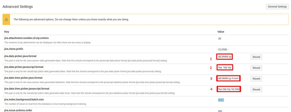

Lukas Gottschall
April 25, 2018
Andy Heinzer
April 25, 2018
I can see a problem with your current settings.  Based on the format you have in #1, I believe that #2 should instead be:
%e.%b.%y
(without spaces, and with the missing '.')   This format has to correspond to the Java format in #1.
Also given the way you have formatted #3 there is another problem.  Since you have dropped the 'a' from the Java format this eliminates the AM/PM from the time.  The problem is that when using the lower case 'h' here, you have no way to represent hours 13-23.  In turn we have to look back at java documentation you cited in https://docs.oracle.com/javase/tutorial/i18n/format/simpleDateFormat.html
Instead #3 I think should be changed to
dd.MMM.yy H:mm
The capitalized 'H' will provide the time in 24 hour format (0-23).
Lukas Gottschall
April 25, 2018
Thanks for the remind for 24 hour support but its not the point here to make it clear my jira works wonderful.
Look at my email adress, i know a lot of programming and this is a damn huge problem to fix.
About 2 days of work.
