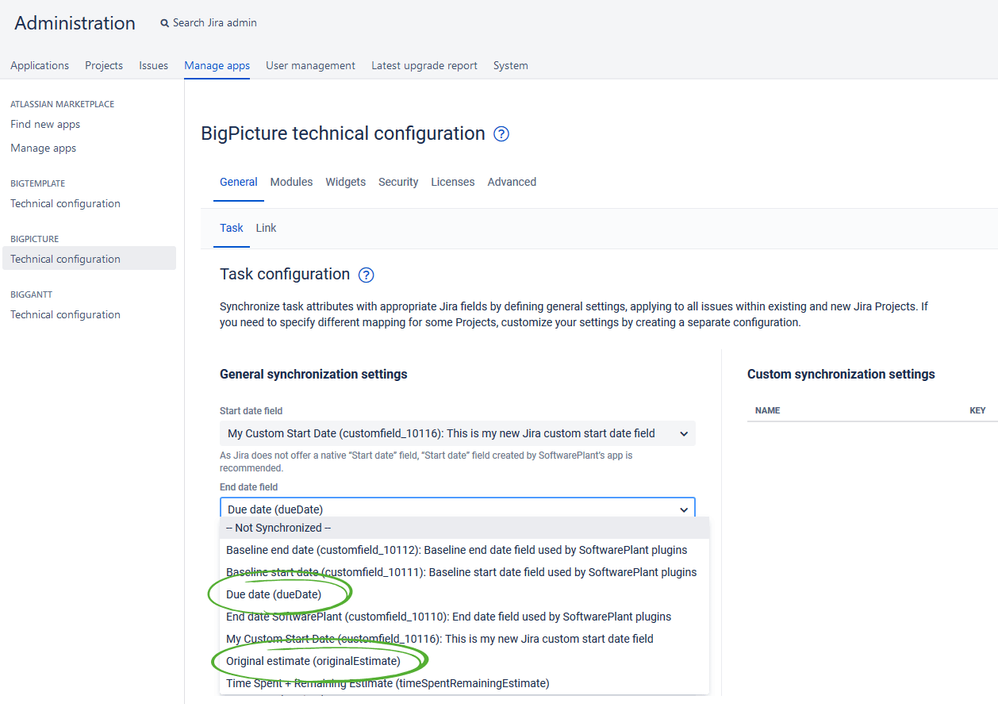

This is how my General configuration is set: (I also tried with End date field: "Due Date" but I had some problems too)

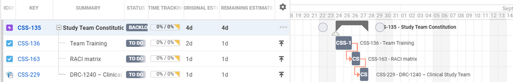

The thing is that I have this Epic, and I changed the start date to 24/08/2020 in the Gantt (manually moving it), so automatically the due date is on 27/08/2020gantt epic.PNG
But even though I Re-Sync when I go to the Epic it shows up like this, the due date is  still the old one, like it hasn't been refreshed...

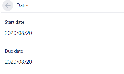

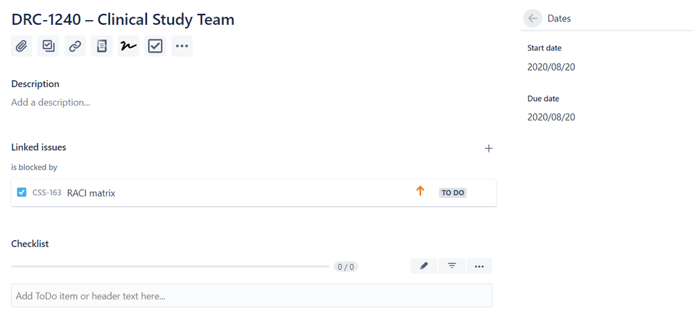

And with the document (CSS-229) it has wrong start date and due date. (This document is a child of the epic and I think that there's something wrong configured with the documents because when I change the original estimate it is not modified in the Gantt and vice-versa)
It's like my fields are not well connected to the Gantt...

Thanks for the interesting question. I investigated the issue a little bit and I think the Due date will not normally get updated automatically based on your Original Estimate. I found tips by the Community that you need a plugin for that. Without such plugin, the Due date is independent of the Start date + Original estimate. The two simply don't keep in sync.
And so you can elect whether tasks' bars will position themselves on the timeline of the Gantt chart based on the Due date or the Start date + Original estimate, as seen in figure 1.
Fig. 1

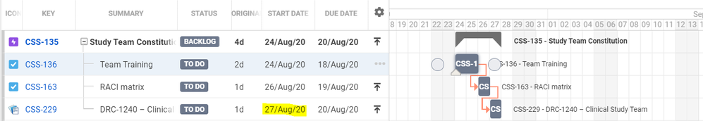

This is my Gantt:

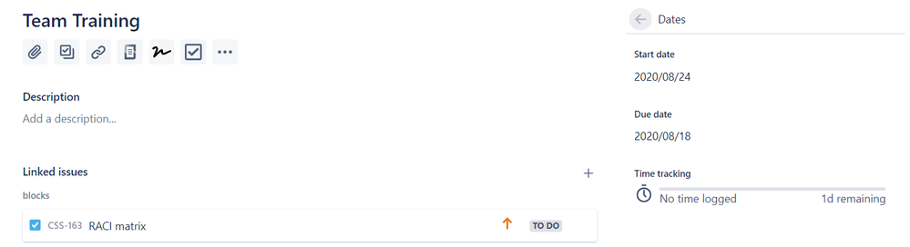

Now I move the Epic to a week after and I Re-Sync, here the document start date seems correct
But when I go to the issue I see  that the start date hasn't been refreshed (it should be 2020/08/27)gantt4.PNG

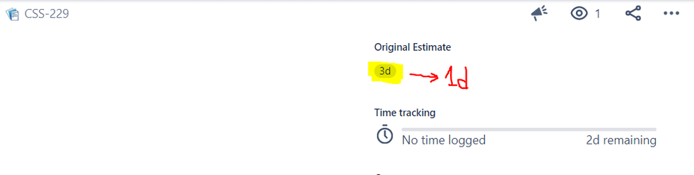

And the same happens with the Original Estimate (I had 3 days at first but I changed it in the Gantt for 1 day). Also I tried to change the original estimate in the issue but even though I Re-Sync the Gantt it wasn't reflected there either...gantt5.PNG

This is how the support team resolved the issue:
(...) as the 'Timetracking' field is not enabled in your Jira project, BigPicture is not able to overwrite it. Hence, it re-synchs the tasks with the original values and, eventually, the tasks are rescheduled to their initial period.
Please follow the guidelines in this wiki section in order to amend your field configuration. This should prevent the issue from reoccurring.
Sara Roig
September 10, 2020
Hi @Marcin Geb _SoftwarePlant_
thanks a lot for your help! At the end the problem was because the Schema of the Documents was missing some fields, I added them and now it works correctly!
