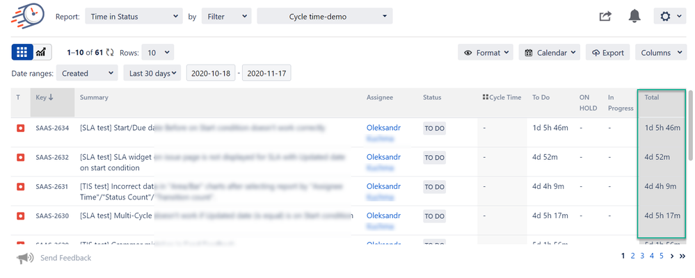

As an alternative, you can try a third-party add-on - Time in Status for Jira Cloud. It calculates the time each issue has been spent in each status.
In the "Total" column you'll get the total time the employee has spent on each incident.

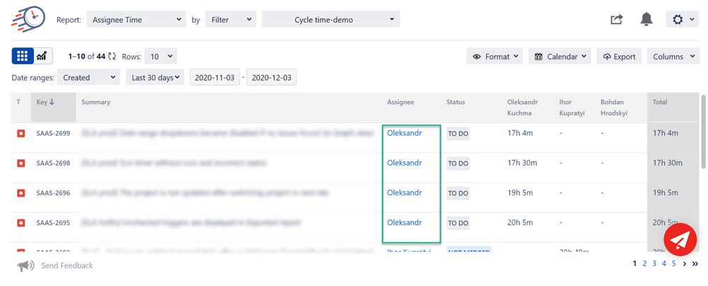

Also, you can choose an "Assignee time" report and it shows how long it takes an assignee to solve each issue.
