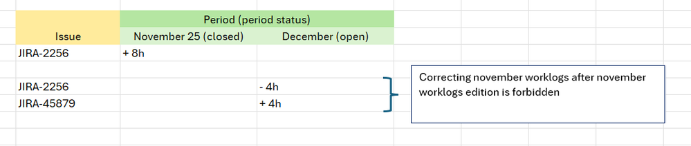

My team uses Jira DC (9.12) with Tempo plugin to track spent times per issue.
Monthly timesheets are extracted and uploaded to Netsuite for global company consolidation.
After timesheets extraction, the accounting team locks the extracted period using Tempo functionalities (timesheet approval + period lock), so that nobody can change the registered worklogs, thus maintaining coherent timesheets between Jira and Netsuite.
Problem : this process does not authorize posterior worklogs corrections, as no time on a locked period can be changed.
We would like to solve this problem by inputing corrective negative worklogs on an open period, so that any correction can be properly tracked : see details below in screenshot.
How can this be accomplished?
