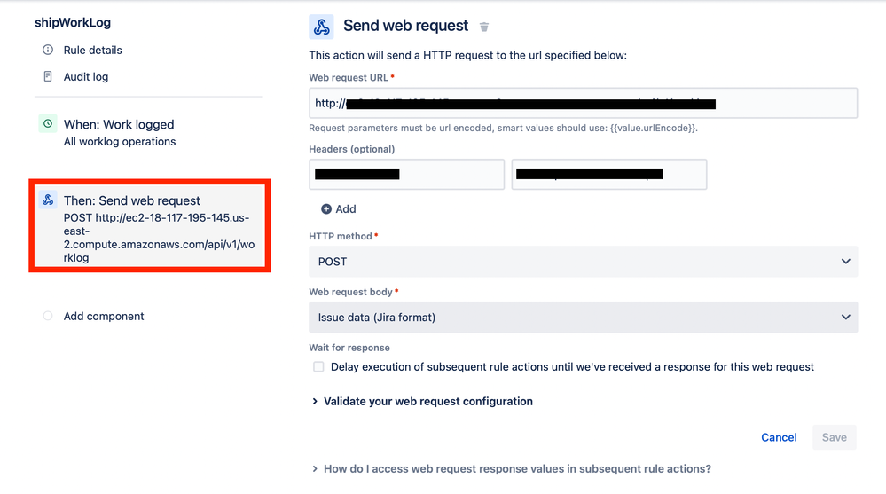

The webhook I'm using was set in a project rule (automation) as a Global rule.
Screenshot 2022-04-23 at 11.22.58.pngThe automation rule is triggered whenever a worklog change, and that is working perfectly. As a response to this event, a webhook call is made and a POST request with the entire issue data (in Jira format) is sent to a remote webserver.

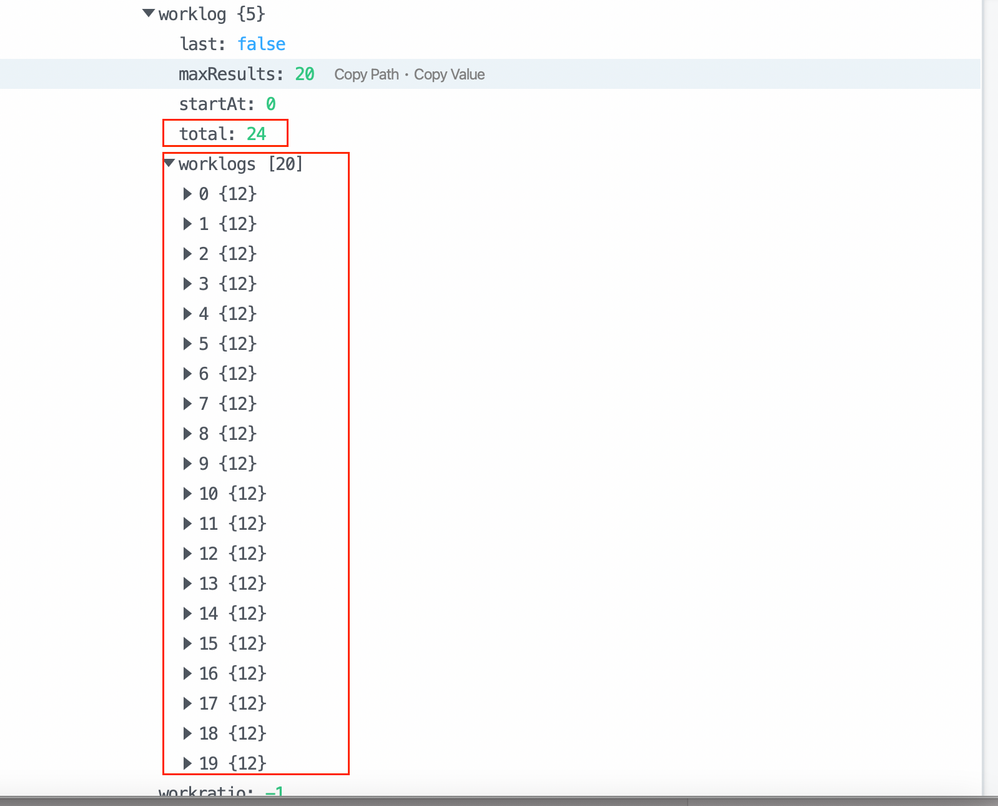

However, I've noticed that when the issue has more than 20 worklog entries , for example,  24 entries that I can confirm via UI (issue activity worklog), the object in the Jira data payload received (issue.fields.worklog.worklogs) contains only the first 20 entries. The other 4 entries isn't listed.
Way to reproduce:
1. create a global (or project) rule automation that is fired when a issue change the fields value of worklog, and set the action to be send a webhook to an endpoint you can check later the data you receive. (you can mockup on requestbin.com)
2. Create an issue and insert 20 entries in its worklog and check the visually (via UI, open issue and see in "activity" , "worklog")
3. Insert a new worklog in the issue to fire the automation rule again or simulate it by clicking and filling the "validate your web request configuration" in the rule action (see first print)
4. Check in the remote webserver the (json) payload data received, and look at the path root/issue/fields/worklog/worklogs, as the second print above. You'll see the total of +20 entries, but can list only 20 of them.
