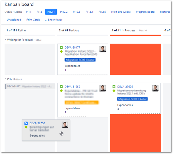

we want to work with sub-task and kanban boards. The sub-tasks were displayed, but cannot be transitioned to another status via drag-and-drop.
As you can see in following screenshot, by holding the sub-task the columns will not be highlighted.

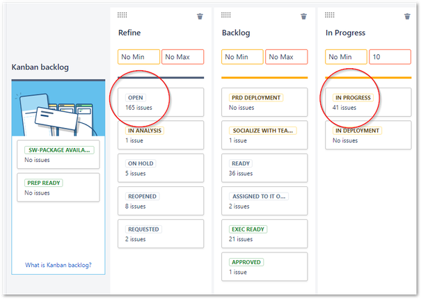

The statuses are mapped properly, there aren't any issues left in the Kanban Backlog. Sub-Tasks uses the statuses "OPEN" and "IN PROGRESS", so I thought this should work.

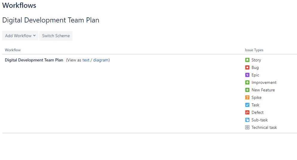

It sounds as though you have a different workflow for your sub-tasks and possibly there isn't a transition set up for just the sub-tasks.
Go to Project settings then Workflows and see if there is more than one workflow listed. Below you can see a screenshot of my project, which is showing that all issuetypes follow the same workflow

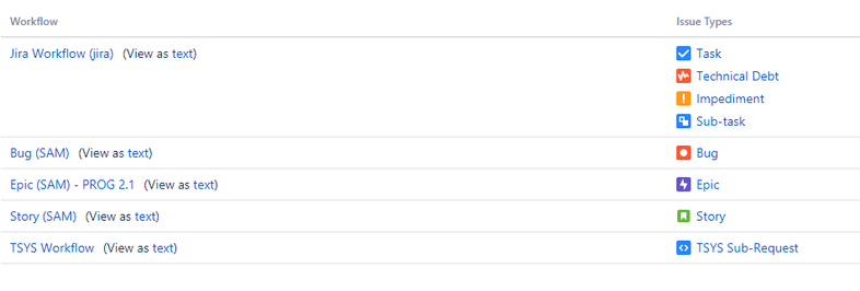

Thanks for your answer. We use different Workflows for Bugs, Epics, Stories and Sub-Tasks.
2019-02-06 10_43_49-Project Development Agile - Workflows - Swisscard JIRA.png
Bug, Epic, Story work fine, but not Sub-Tasks.

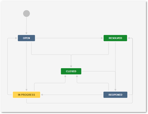

Is that an Issue? The Sub-Task uses a standard workflow, the statuses are mapped in the kanban board.
2019-02-06 10_46_04-Project Project settings - Workflow for Sub-task - Swisscard JIRA.png
