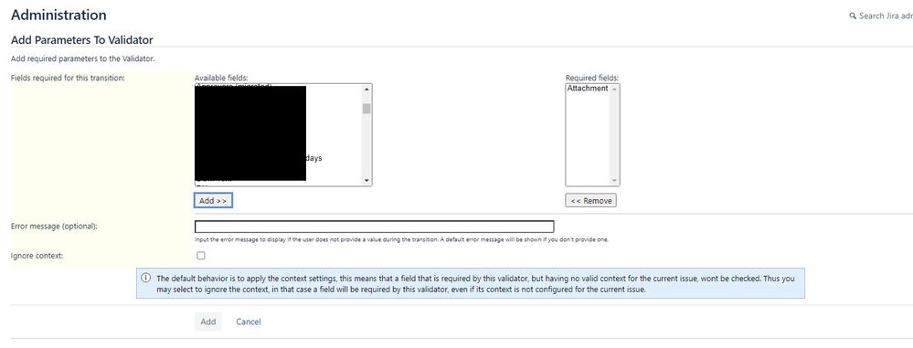

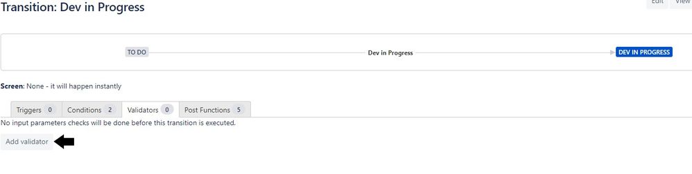

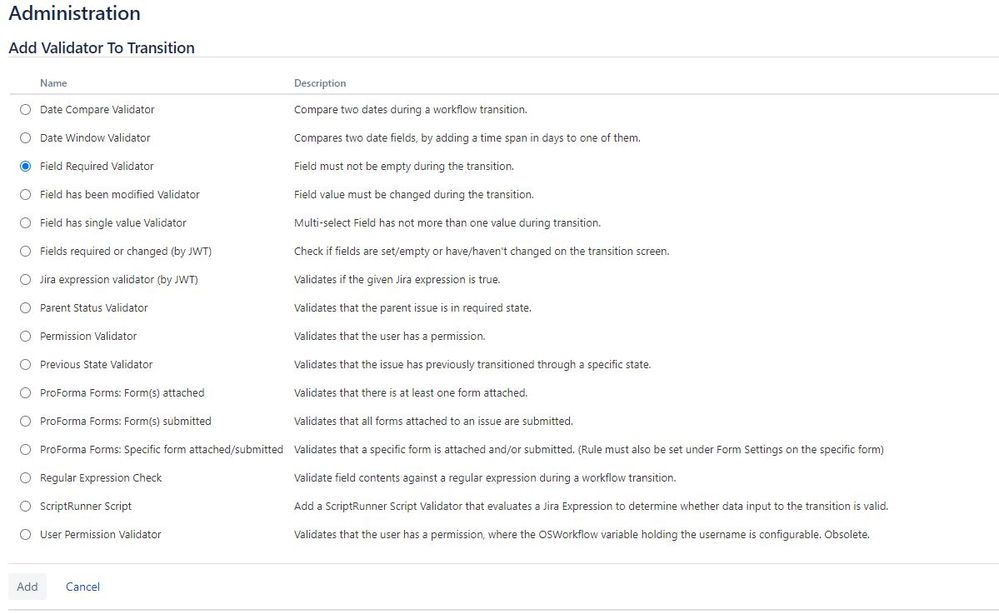

Hello @Adam Foot
To ensure that the transition happens from status A to status B only if it has an attachment, please add a validator to the transition.
Please refer to the below screenshot for implementation.
NOTE: This will require admin privileges. Kindly contact the instance administrator for this.
Please accept the answer if this helps solve your query else respond and allow others to share input.
Adam Foot
August 3, 2021
Hi Gaurav,
I did also try this validator rule before posting here but unfortunately it doesn't work. Whether I upload an attachment or not, it's unable to transition.
To clarify, there are no other validators or conditions on this transition & when I attempt to transition the issue the error message appears that I've typed in for this validator rule (this validator rule is the source of it being unable to transition).

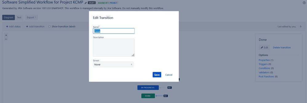

Gaurav
August 3, 2021
Hello @Adam Foot
To add a screen to the Transition, please open the workflow in edit mode, select the required Transition and click edit. From the dialogue box select the required screen and click Save.

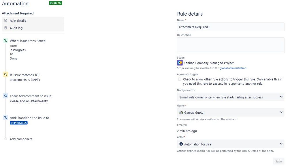

Gaurav
August 4, 2021
Hello @Adam Foot
I have just tried using automation to achieve something similar, but not perfect. The automation would check for attachment any time an issue is transitioned from Status A to Staus B. This would take into consideration any attachment added to the issue, previously as well.
If the attachment is missing it will transition the issue back to Status A and add a comment.
Adam Foot
August 4, 2021
I've added this rule & the transition back to the previous status. I'm able to move the issue between back & forth between the two status types - great.
However, the Automation rule fails with: "Error transitioning issues
ITP-29 (Can't move (ITP-29). You might not have permission, or the issue is missing required information. If you keep having this problem, contact your Jira Administrator.)"
To confirm, the automation rule is running as actor "Automation for Jira" & the transition back is stock standard without any conditions or validators.
